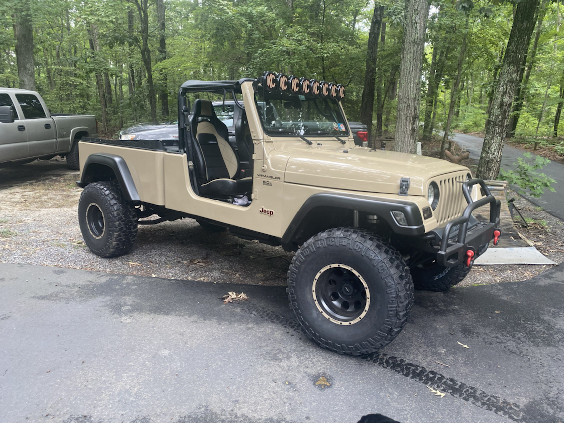

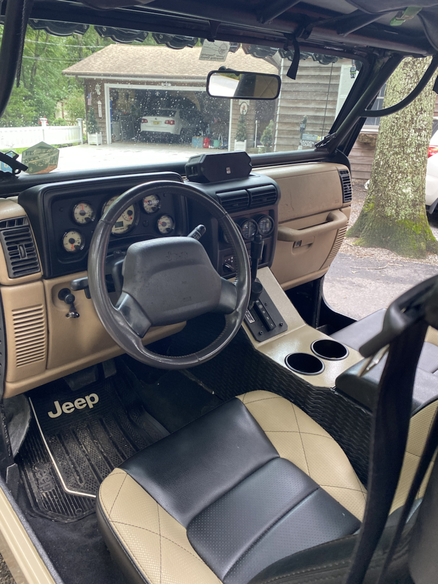

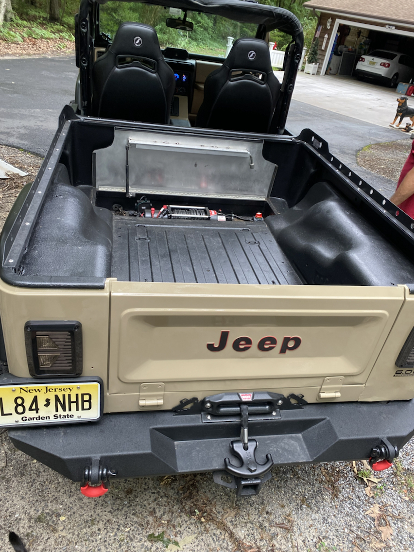

For my $$, I would buy a 4-door and start with that. But check out the build my brother did with a TJ. He extended the frame and I think he has a supercharged v8 in it. Has no problem lighting up the rear wheels on pavement.
