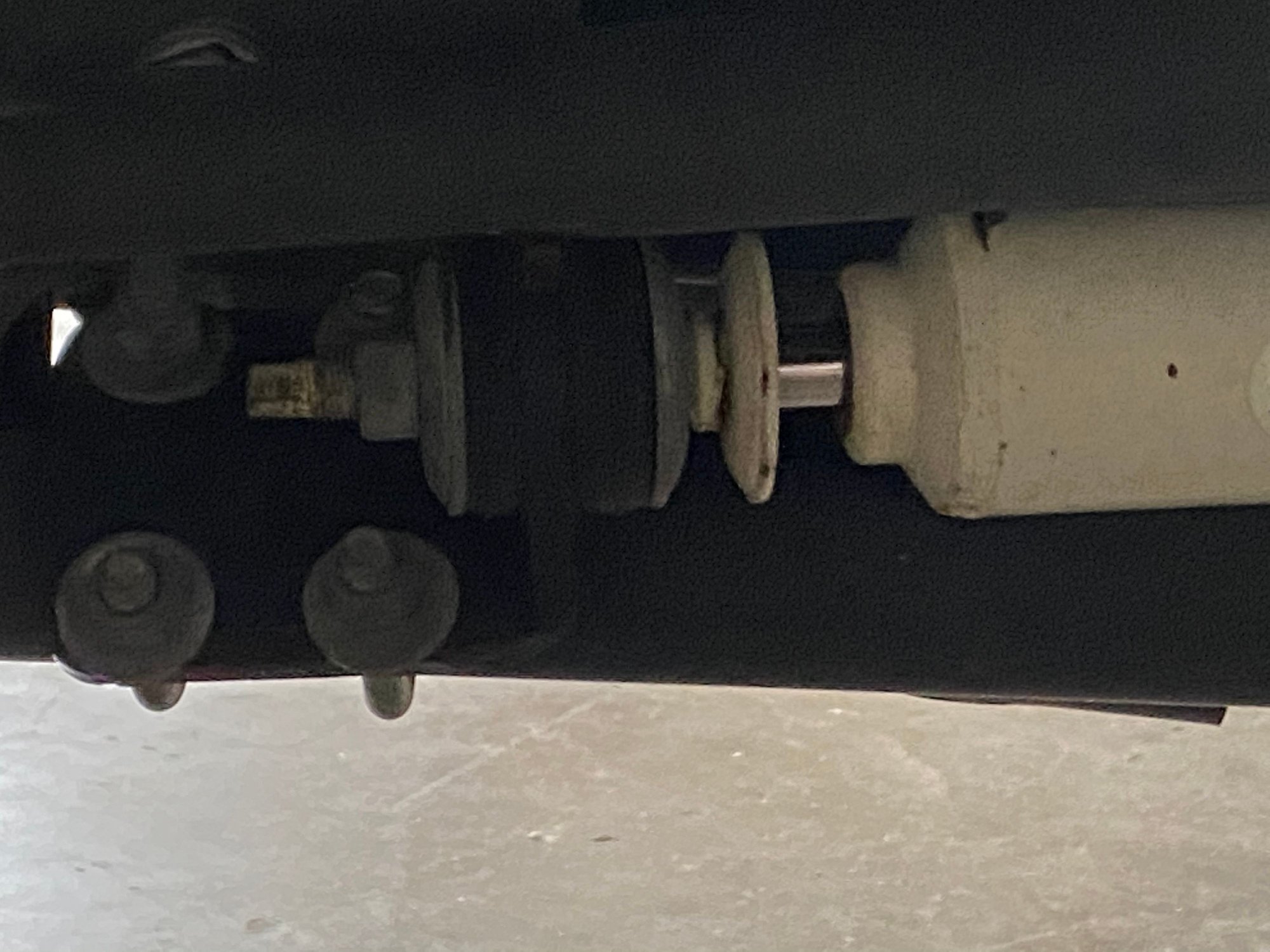

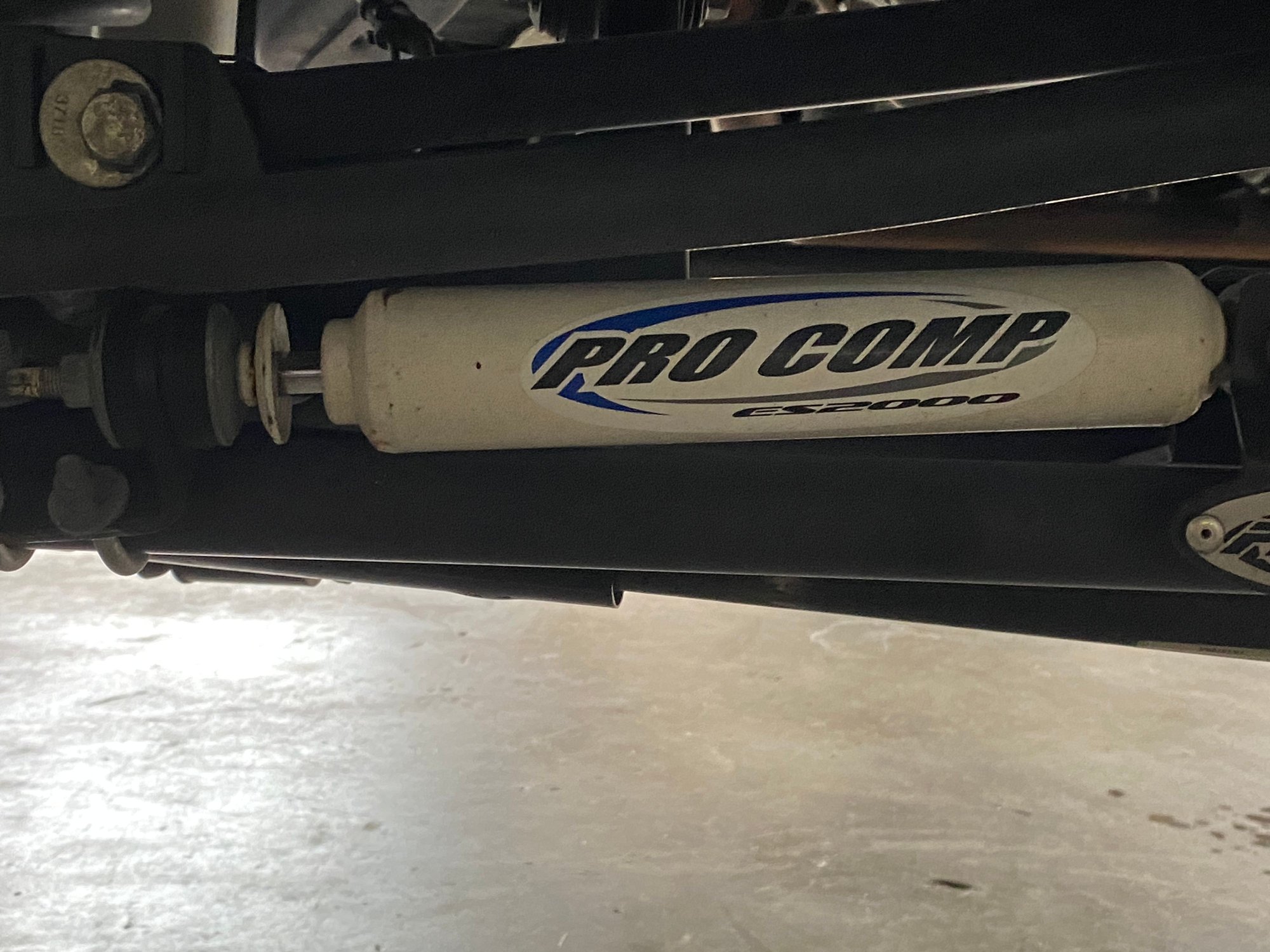

Old Apr 19, 2021 | 03:44 PM
TMilliner's Avatar
Joined: Apr 2021
Posts: 10
From: Largo, Florida

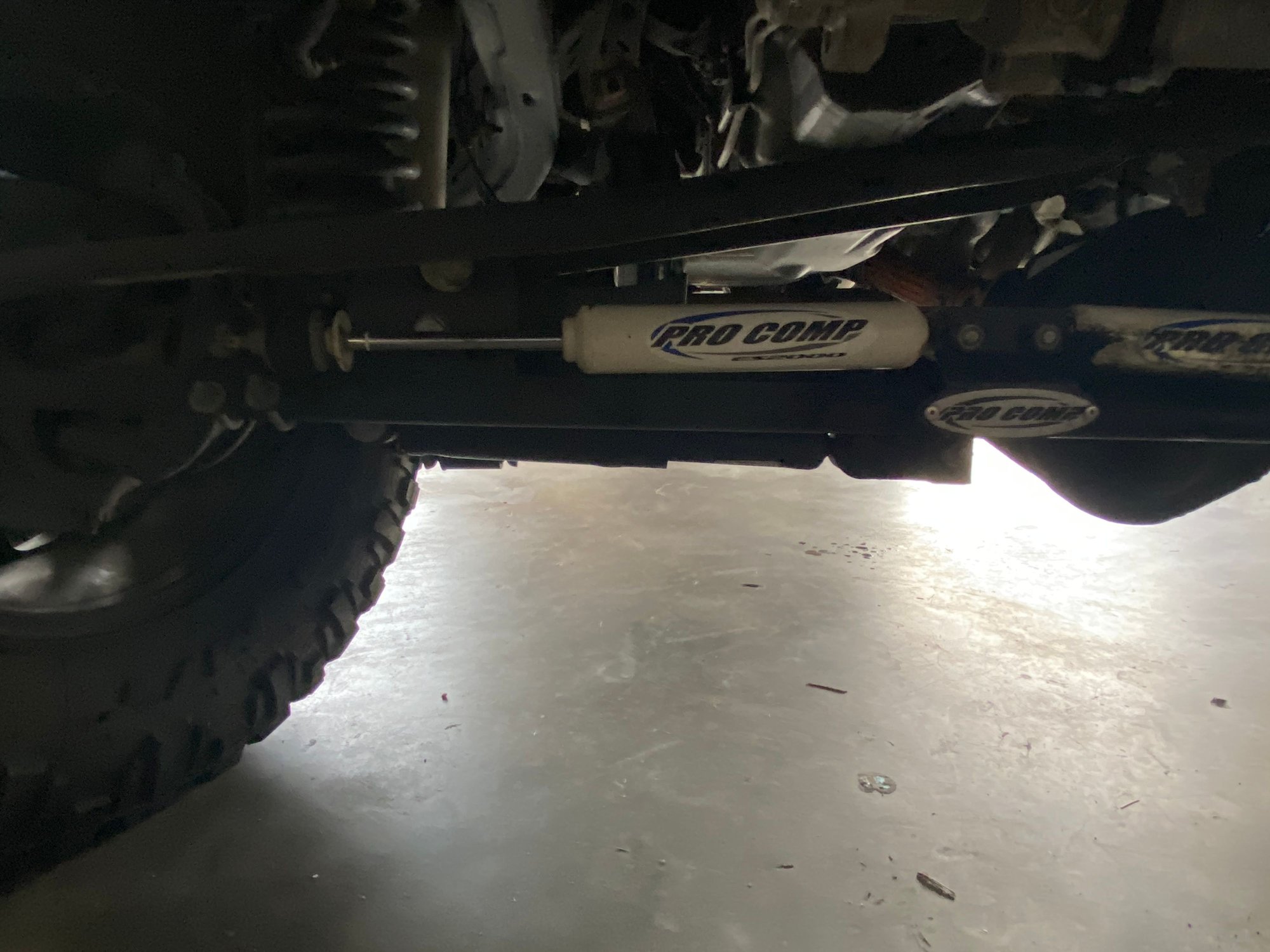

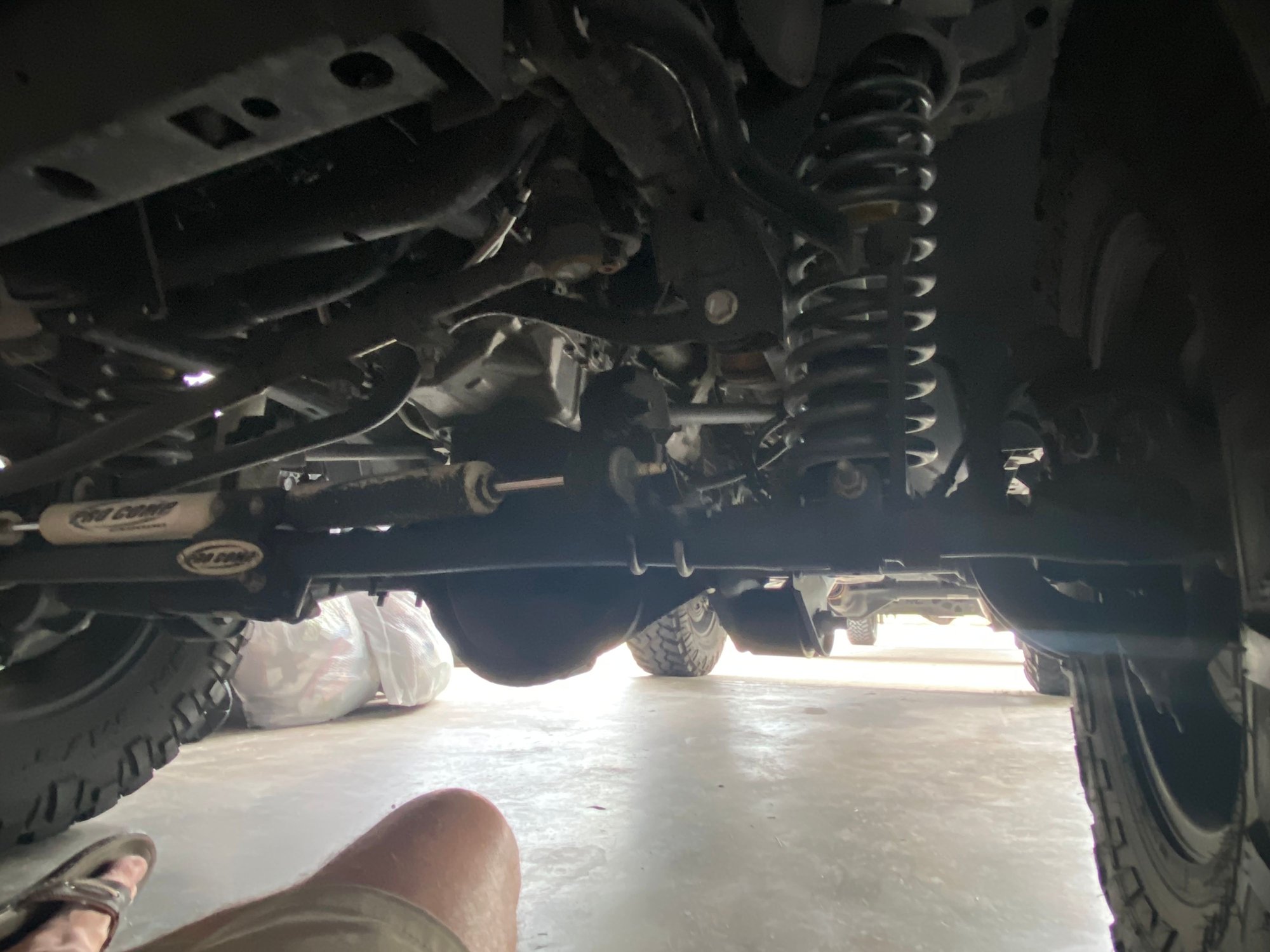

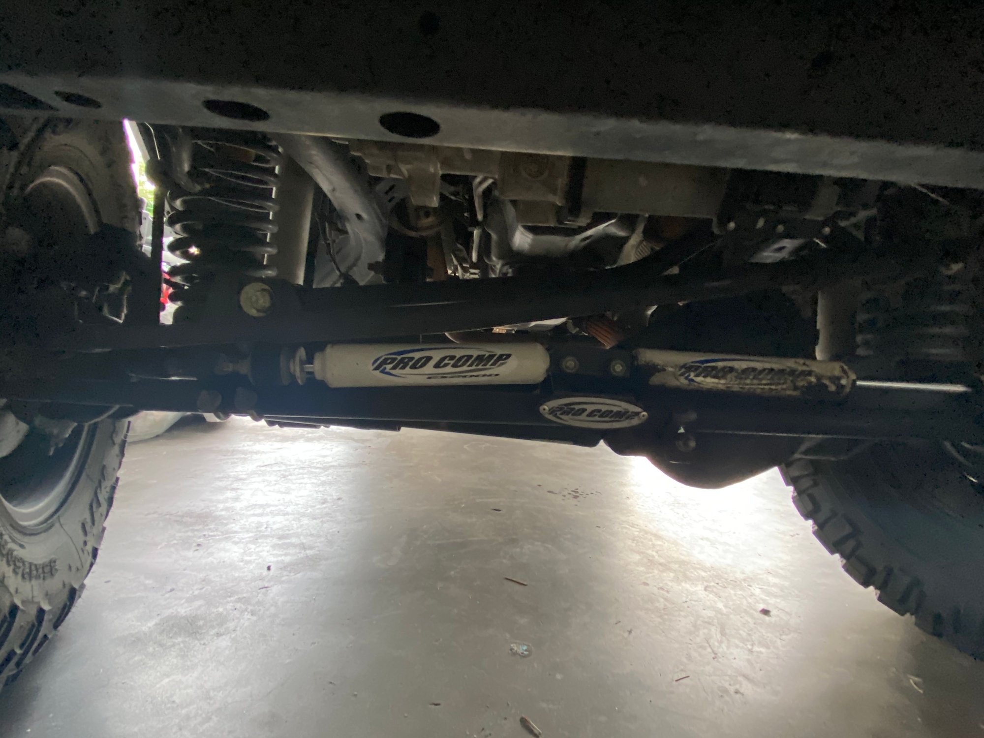

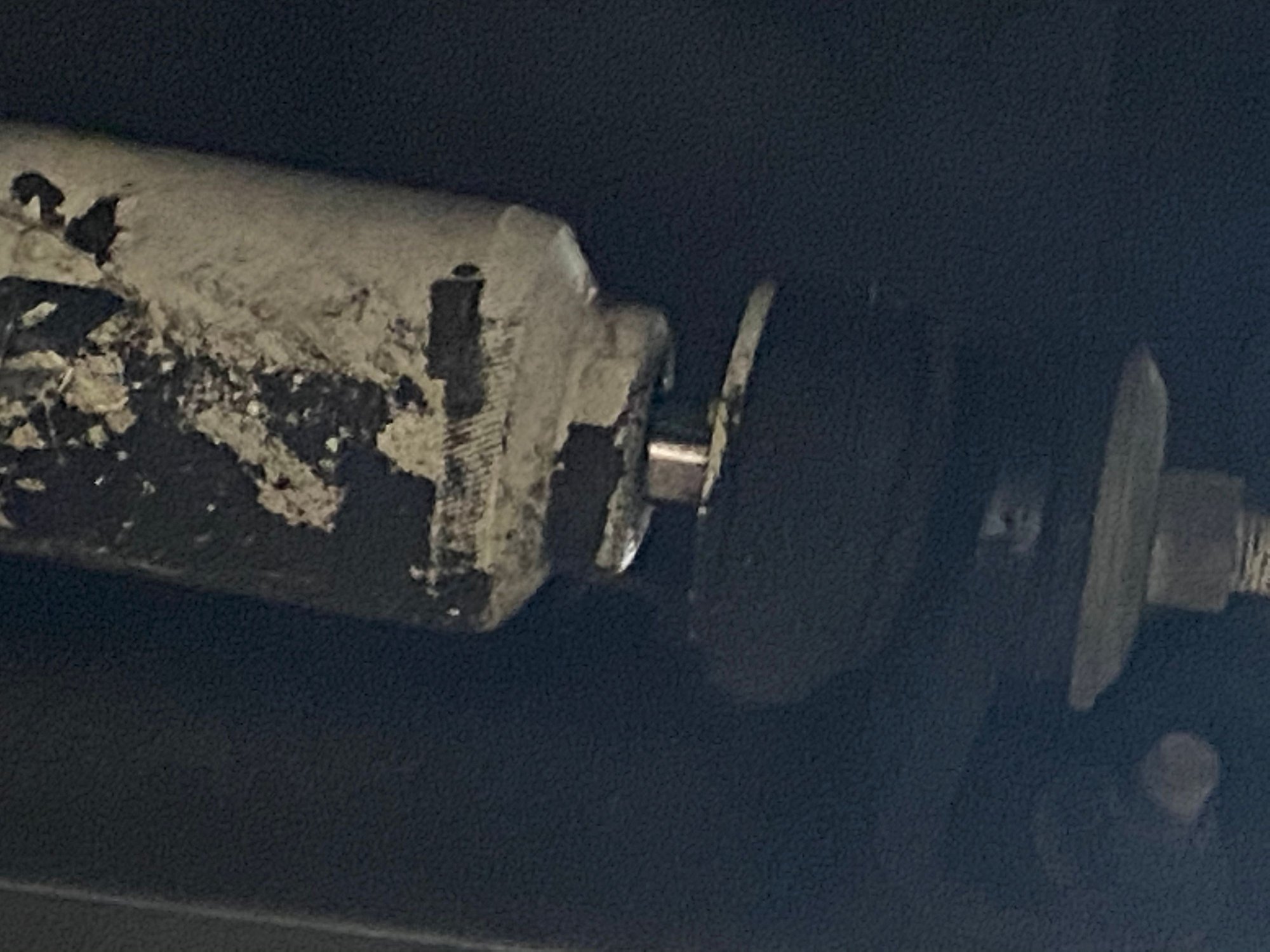

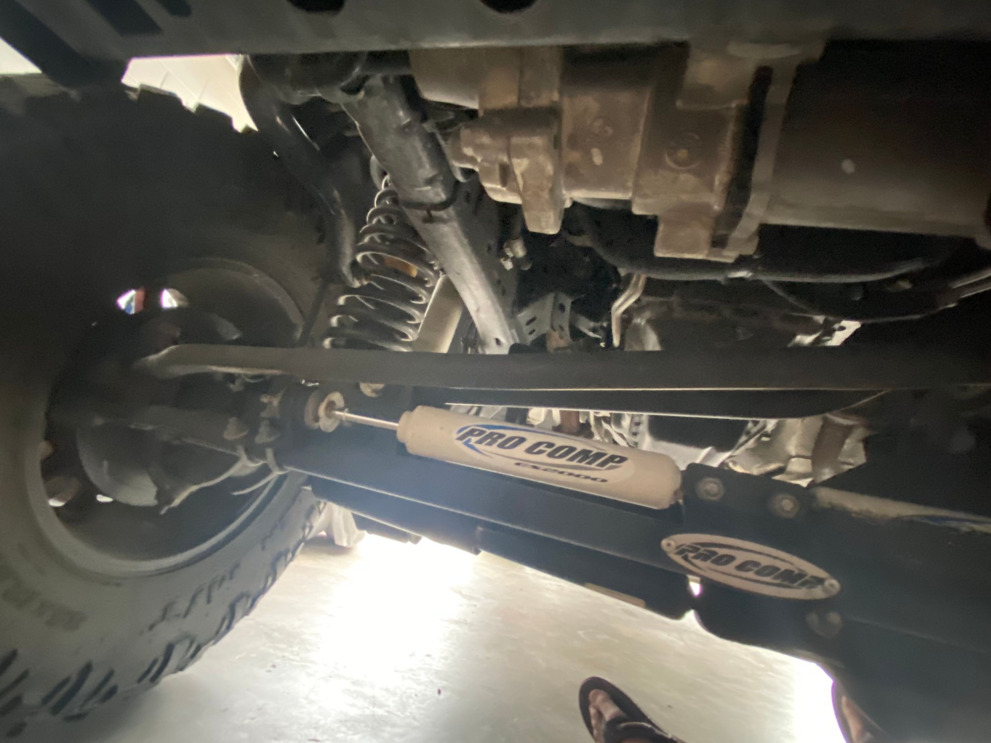

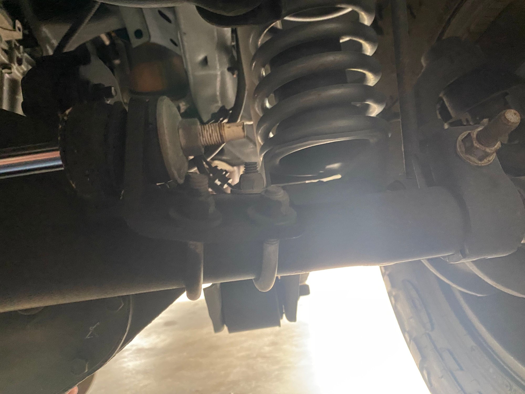

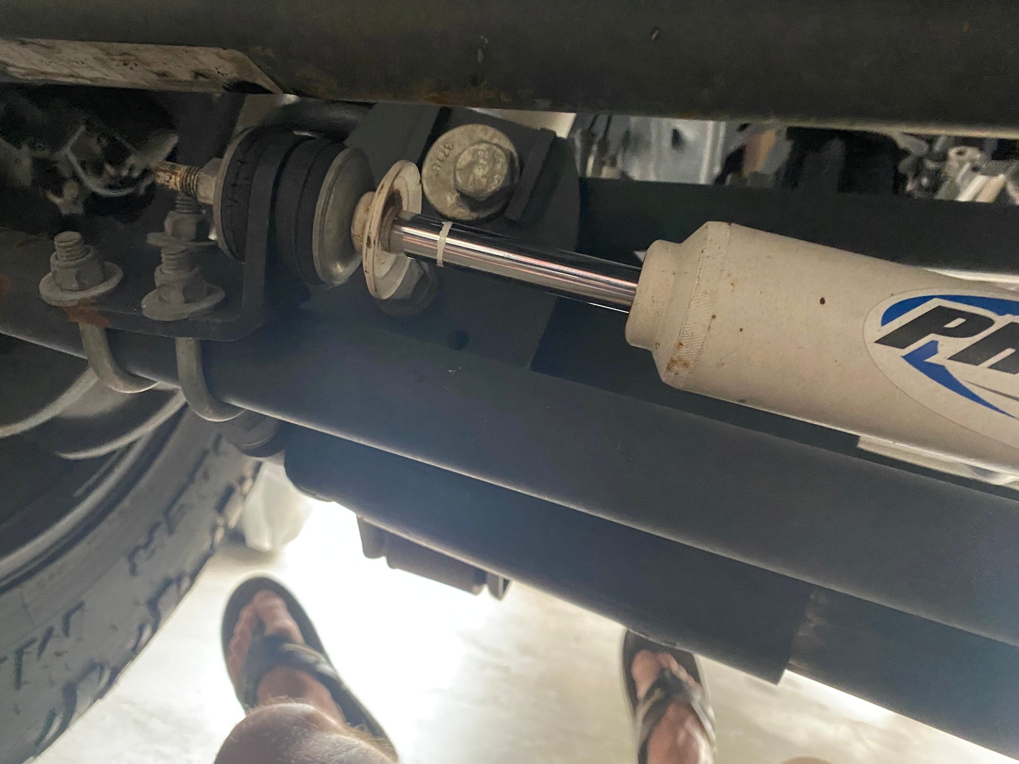

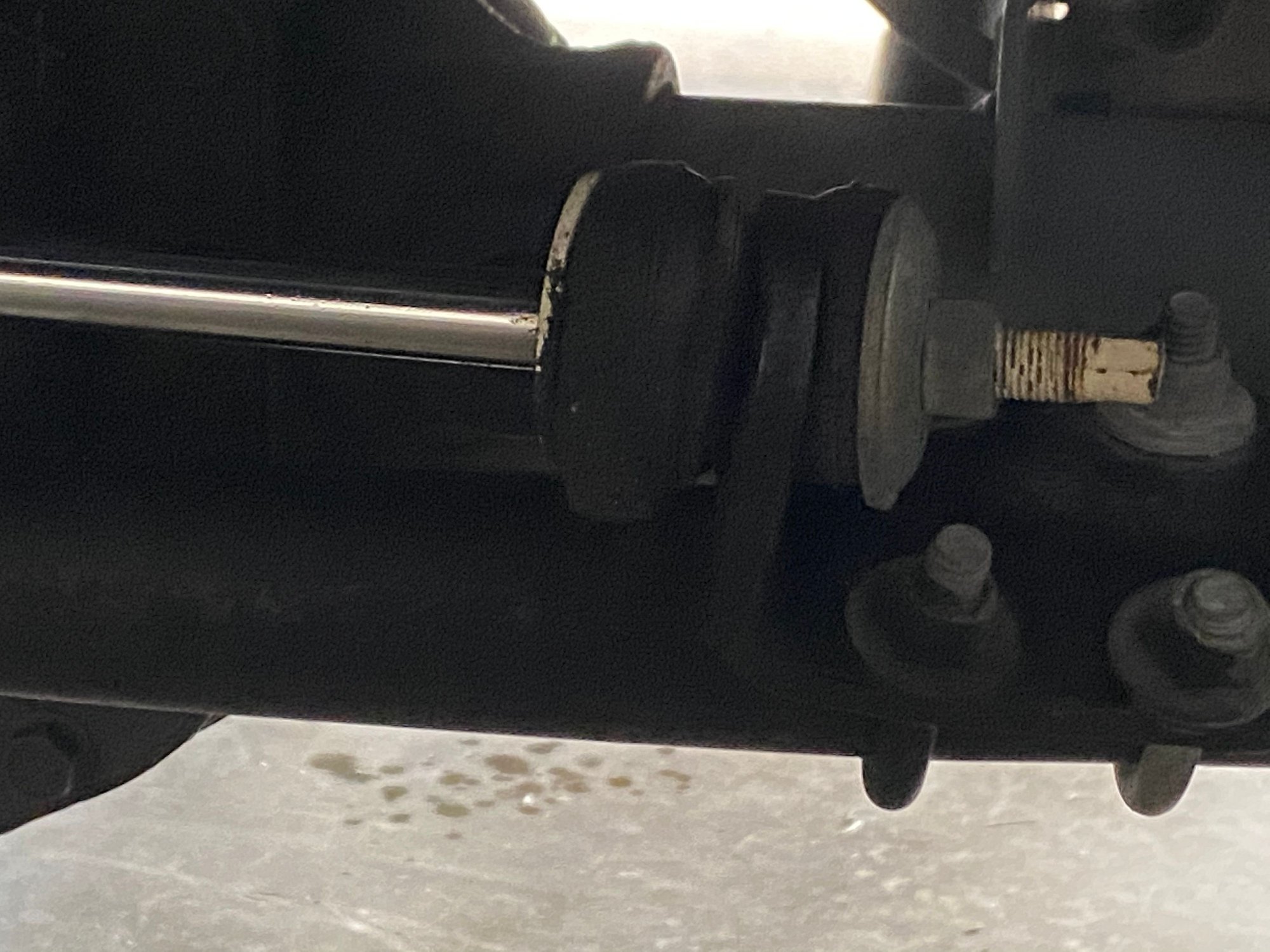

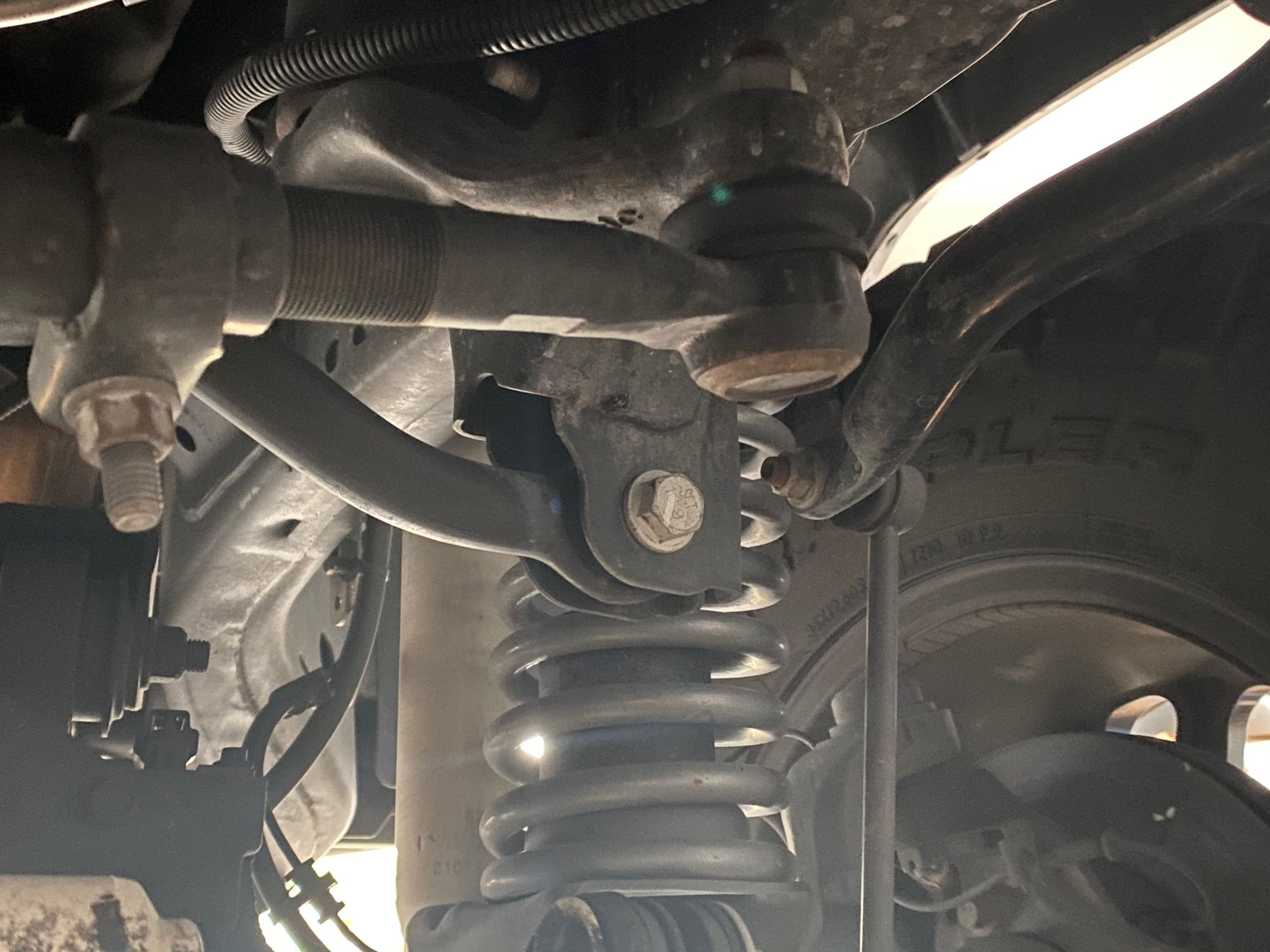

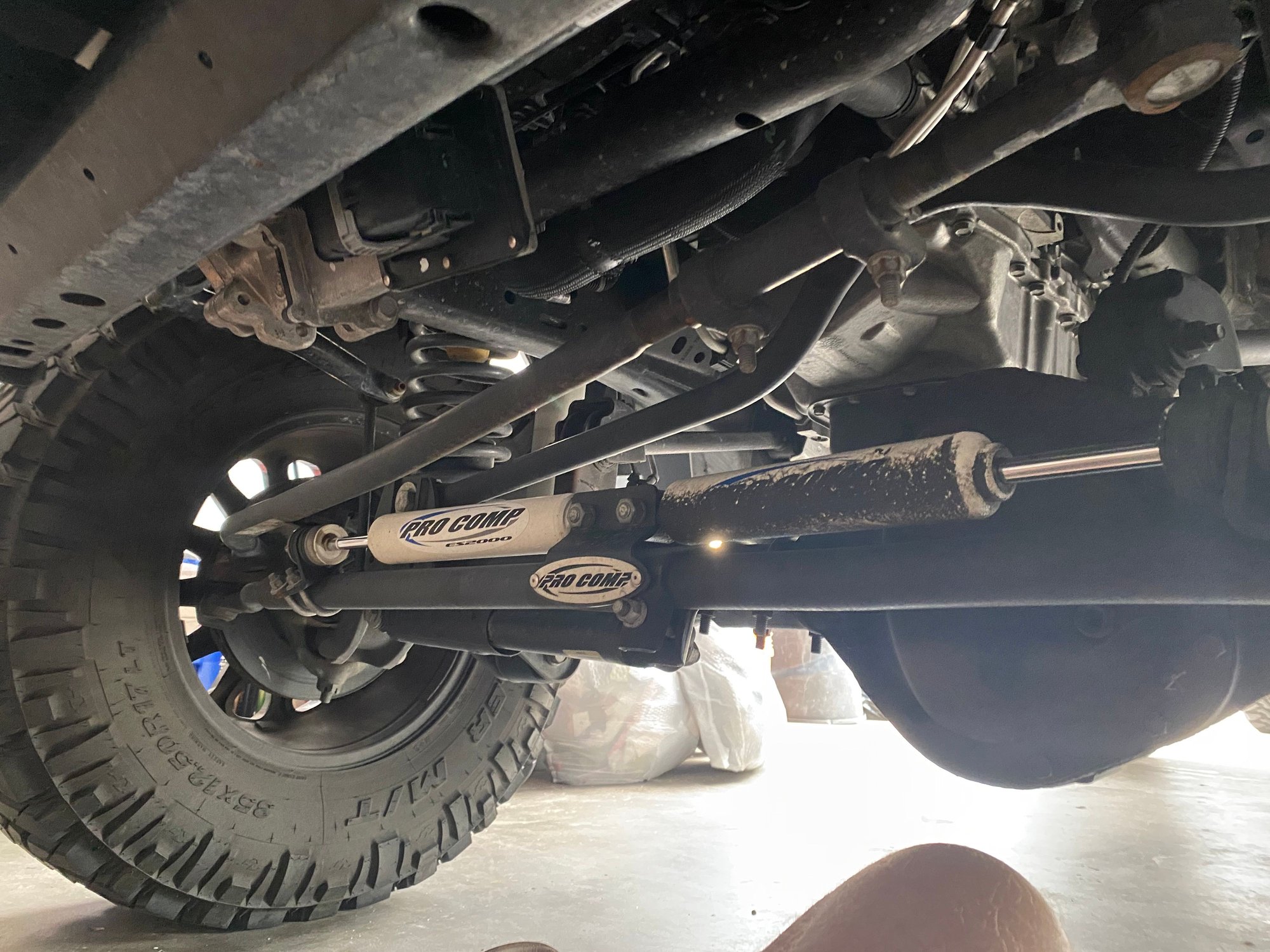

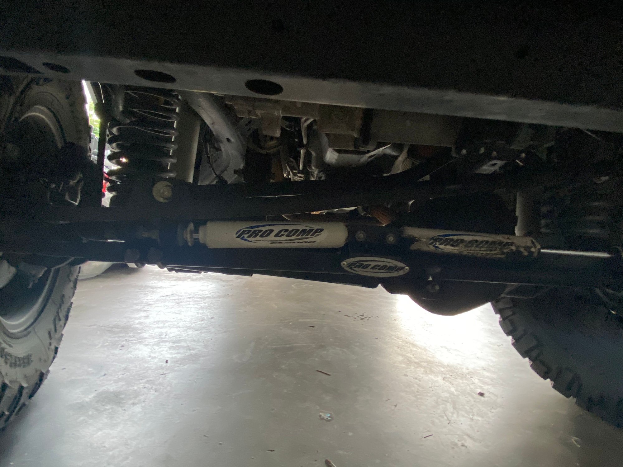

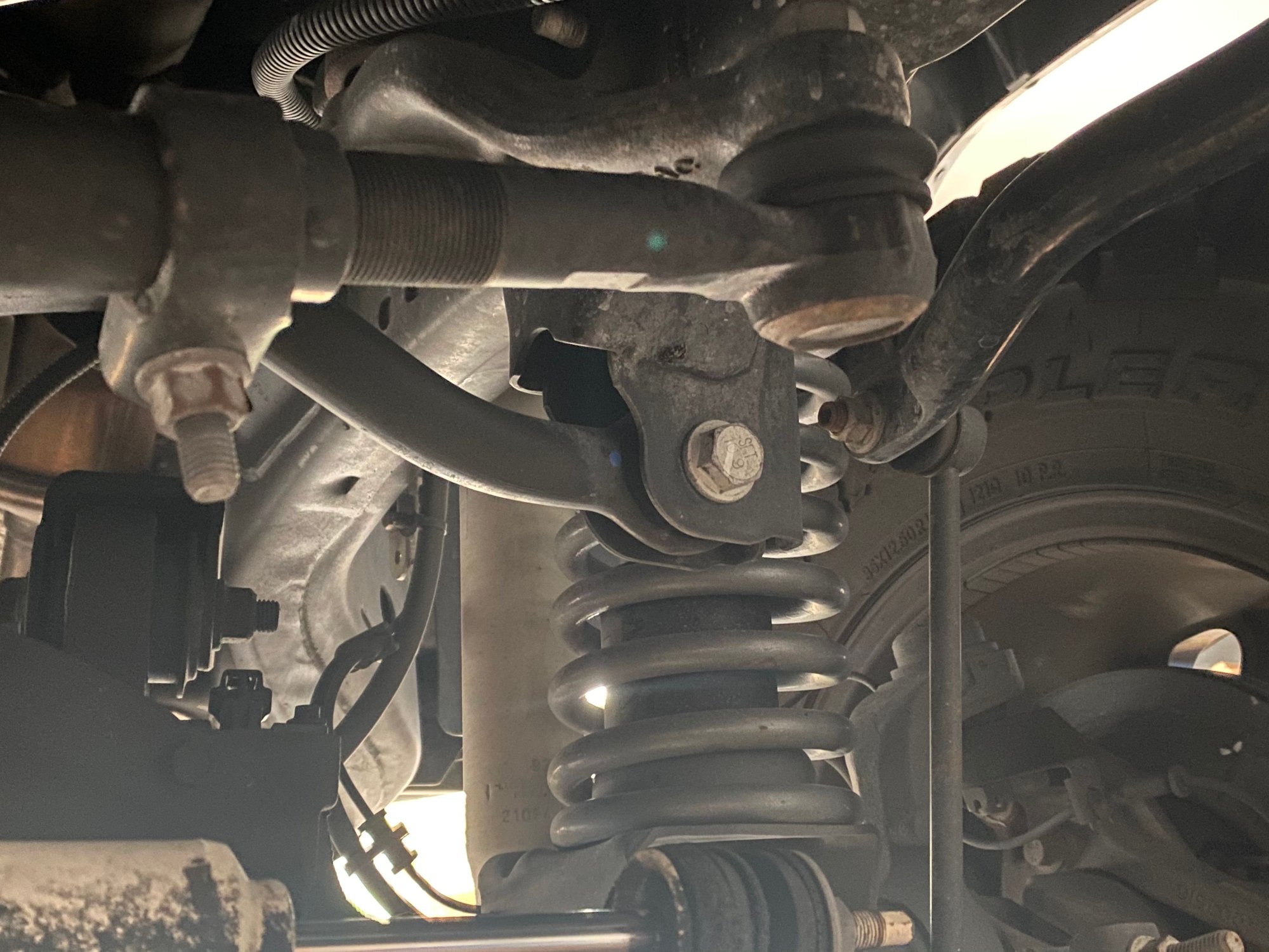

Old Apr 19, 2021 | 03:49 PM
TMilliner's Avatar
Joined: Apr 2021
Posts: 10
Looks like a bent bracket on the drivers side stabilizer. Could that be the cause?
Old Apr 19, 2021 | 03:56 PM
Sv_dude's Avatar
Super Moderator
5 Year Member
Loved
Community Favorite
Joined: Mar 2020
Posts: 857
Likes: 123
From: Prescott, AZ
First observation is that you have 3 steering dampers, wow! Whoever installed the procomp setup should have removed the factory damper. And yea, your procomp damper bushings are definitely bad, and it looks like your driver side damper is blown. I’d just remove all the dampers, that may be a one handed job if you can tackle it.
However, that won’t cause your steering wheel to stay to one side when you go over a bump. If you hit a bump and your steering doesn’t return to the same place then you have a bigger mechanical issue. Do you have a large dead spot in your steering? Meaning, when you drive, are you able to turn your wheel a good amount before you get a corresponding turn from the wheels?
