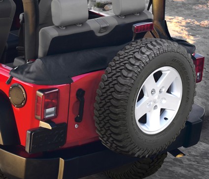

As you can see in the diagram below, back spacing is the distance between the Mounting Pad (surface that makes contact with your axle) and the outside edge of your wheel.
The offset and back spacing on the factory JK wheels are designed to keep your tires underneath your fender flares and keep you legal in most states. The only problem is, installing wider tires on factory back spaced wheels usually results in the rubbing your tires side walls on suspension components, which as you can imagine is not good. This is why most Jeepers choose to install new wheels with common less back spacing such as 3.75", 4" or sometimes even 4.5". Less back spacing will move wider tires outward and away from any potential rubbing problems.
