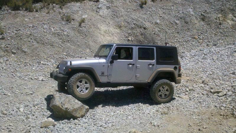

Welcome to the forum. you have a Jku and do you have a lift. as for me i have an 08 jku with 3.5 lift with rock sliders canister skid and a sway bar skid that's it.
