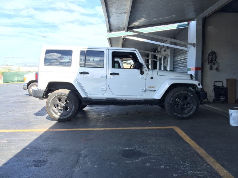

Originally Posted by rugahrahj
This is something I could program myself with the procal right?
Yes, any of the programmers/tuners will let you adjust the tire size and gear ratio.
The procal uses dipswitches, the flashcal has a screen and is internet update-able. The procal will let you adjust tire psi settings and shut the tpms system off completely. The flashcal will not adjust psi any more, it will only let you turn it off.
Old Mar 22, 2016 | 12:36 PM
rugahrahj's Avatar
Joined: Mar 2016
Posts: 80
From: Miami
Originally Posted by nthinuf
Yes, any of the programmers/tuners will let you adjust the tire size and gear ratio. The procal uses dipswitches, the flashcal has a screen and is internet update-able. The procal will let you adjust tire psi settings and shut the tpms system off completely. The flashcal will not adjust psi any more, it will only let you turn it off.
good to know bro thanks...I was able to lift the rear today myself...I should be able to lift the front end tomorrow morning
