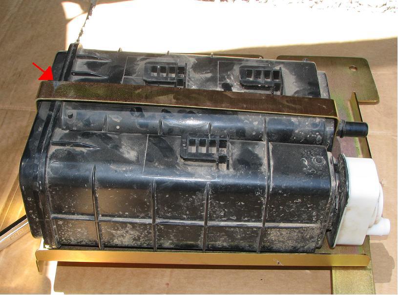

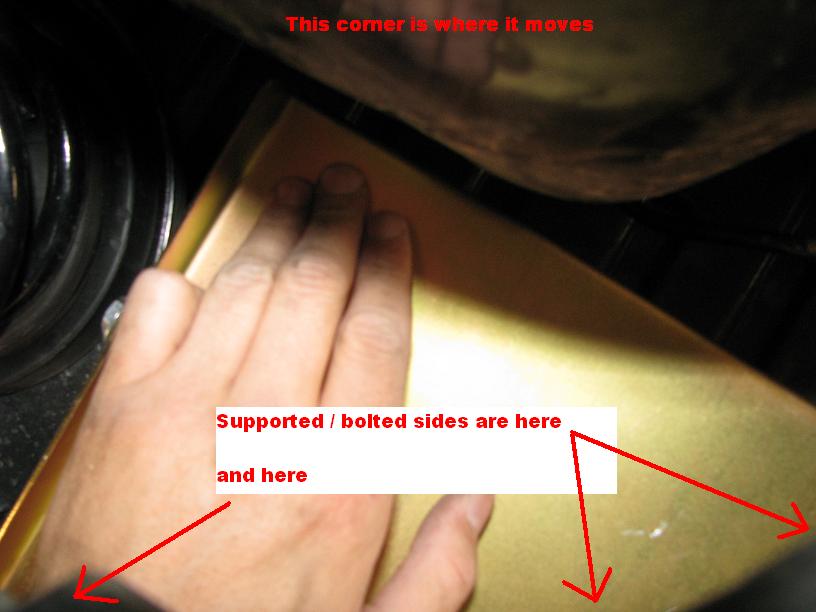

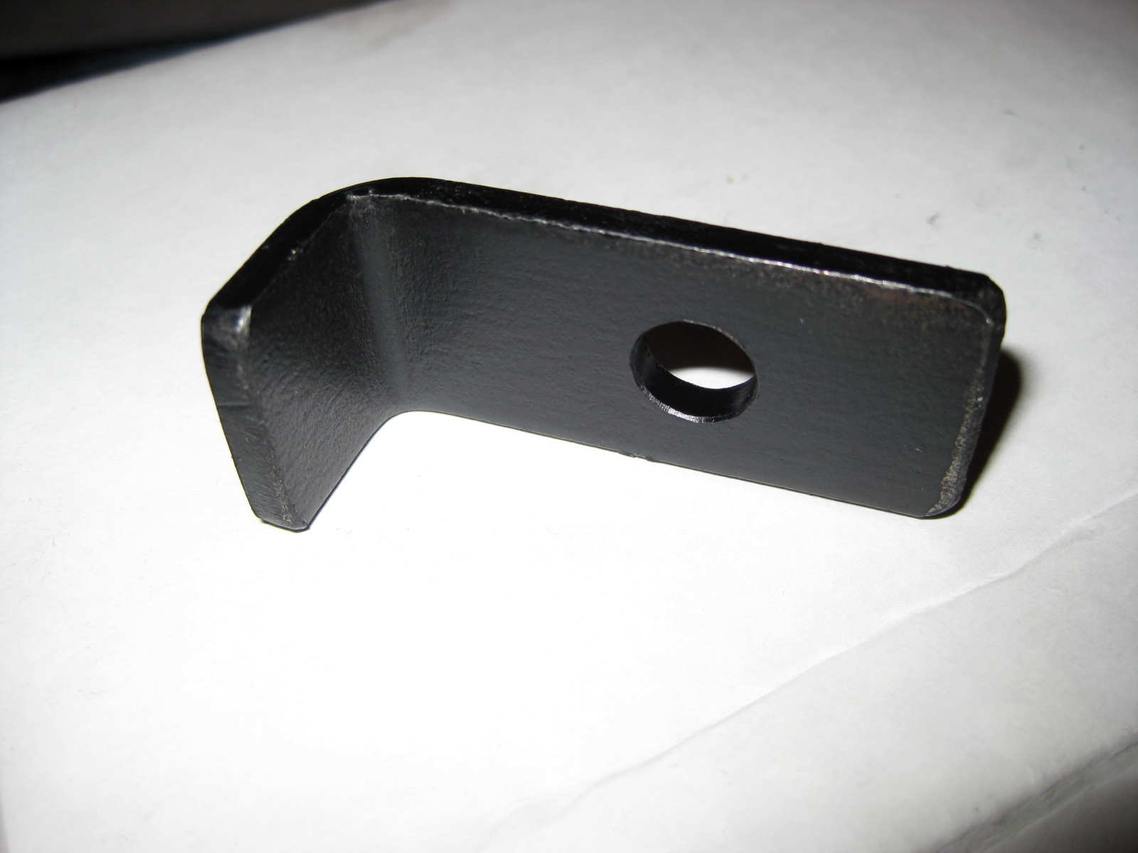

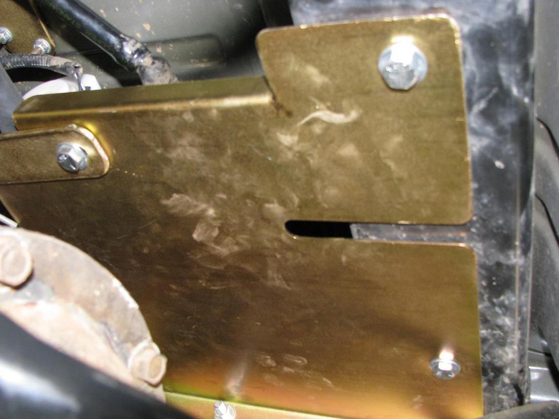

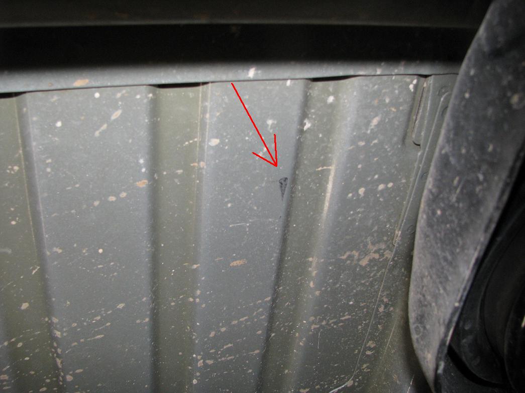

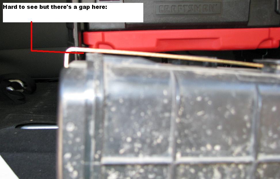

Ok they're bigger... too big!

I removed it and re-installed it twice, I bent the metal strap a little to get rid of the gap and it was more snug against the evap canister. But... it still made contact with the tub.
Then I reversed the metal plate in the frame... worse.
Lastly, I dropped it, placed some 1/4 inch closed cell foam (old sleeping pad) between the tub and the top of the canister. Then tightened down again and well it doesn't clang anymore.
Still not the solution I was hoping for so I'm open to any suggestions.

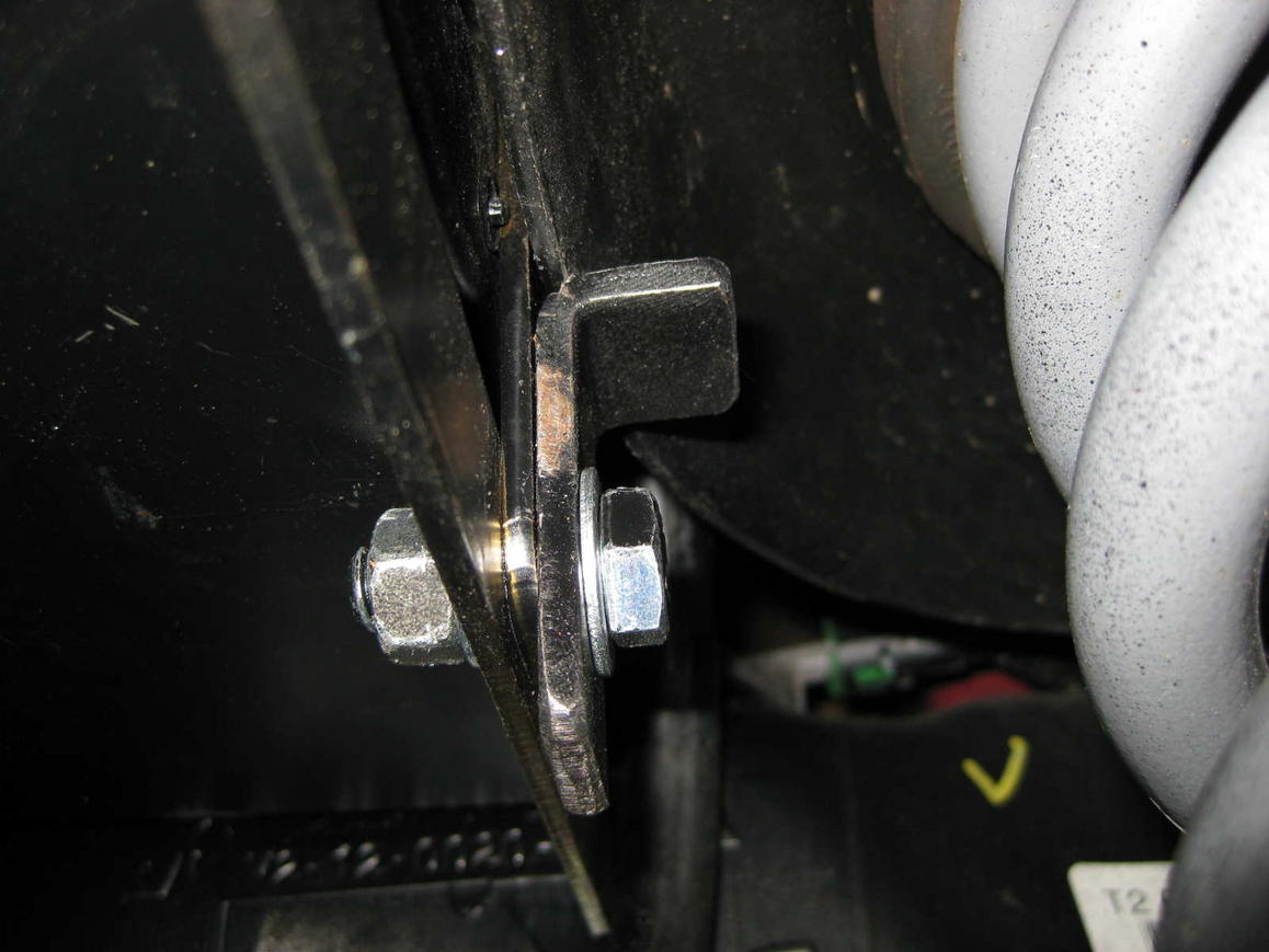

I had the same problem with the Kilby evap relocation skid allowing the canister to hit the tub causing a thumping sound when going over bumps. I solved this problem by fabricating a bracket that attaches to the skid and rests on the spring retainer pushing the skid and canister away from the tub. This mod has been in place for two years and works perfectly.

I contacted Kilby and they said:
"You're the first of hundreds to experience this. Not sure why, but it looks like your strap may be bowed up slightly? If so, you may try to open the hole on the mounting plate (longer) to alleviate the bowing. Let us know if this works."
Oh well. I guess I'll keep the foam in there. I like the fab blocker above, that is nifty.
