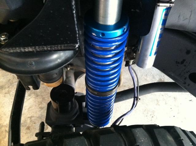

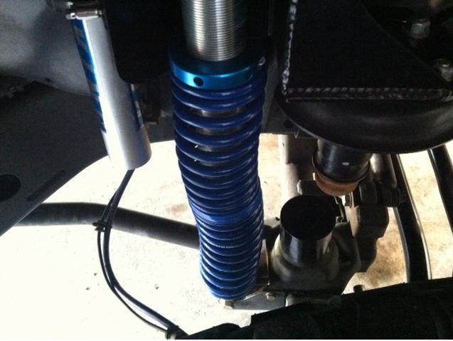

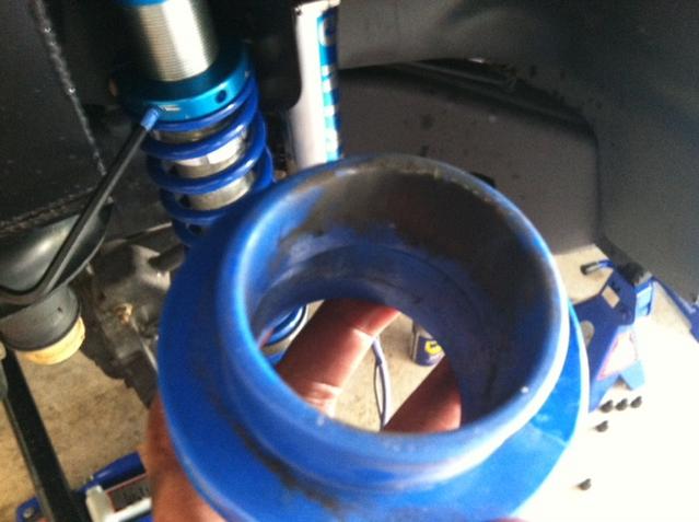

Installed AGM spacers on the 2.0 KING coilovers, what a difference. Noticed the stock spacers allowed alot of grinding and were not properly aligning the coils.
Test drive went well, no noise!, straighter coils, and actually slightly better ride. Worth the extra $$$. Definatley getting some for the rear coilovers as well.
Before Pictures:

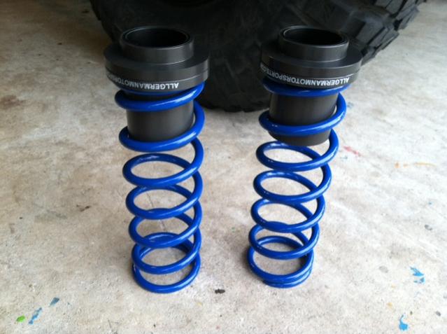

After Pictures:

The last one on the before pictures is the POS original blue spacers.

Damn man, they didn't look that off when I saw em up close in Luling, now I really see it. Nice fix, how much the spacers go for?

Dude, you should here the stock spacers off roading. Really noticed them when slow crawling...everyone says they're normal, but I knew the shock bodies wouldnt last long with all that grinding, binding, and rubbing. The ride got a little smoother as well, guess straighter coils help. The AGM spacers go for $200 (1 set only). Now, gotta go on a Raman noodle diet for a week to get the rears matched!
