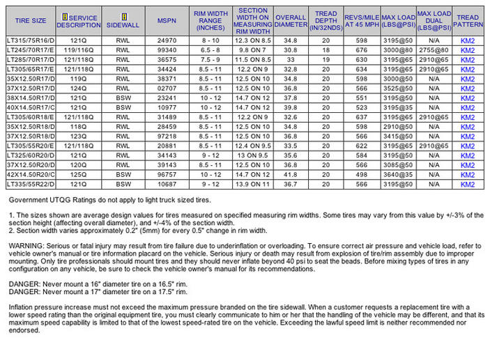

Does the KM2 come in a 33x12.50-18?
Old Jan 14, 2013 | 05:26 AM
swaite3's Avatar
Posts: 758
From: pittsgrove nj
No but the 305/60r18 is equivalent

But to be honest I would consider the 35x12.50r18, they run small if mounted on a 7.5" (stock) rim they measure 34" and on a 8.5" rim closer to 33.5"
No, but check out the KM2 spec page on the BFG website, you can get pretty close to what you want. Mud-Terrain T/A KM2 | BFGoodrich Tires
305/60/r18 is your best bet. 32.6"x12.2"

I'm running a 18x9 so that would make a 35 closer to 33 correct?
Old Jan 14, 2013 | 08:47 AM
swaite3's Avatar
Posts: 758
From: pittsgrove nj
yes 33.25-33.5 one the jeep

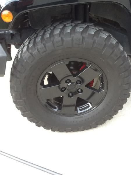

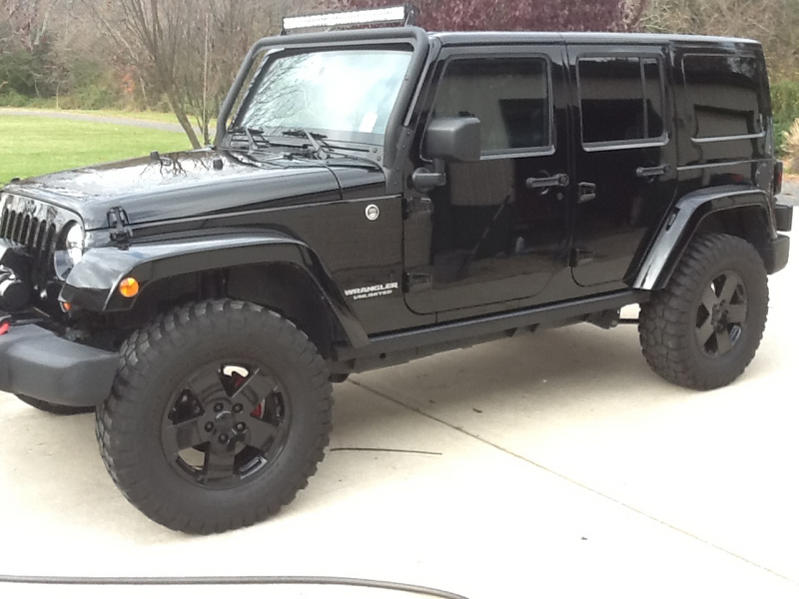

this is my old set up with 35x12.5r18 km2's on 7.5 rims 1.75 front coil spacer lift .75 rear and 1.25 body lift
ID:	409422   Click image for larger version
