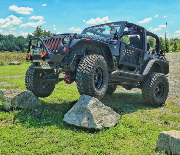

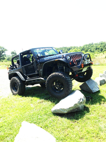

Hey all. I was out driving and saw a few rocks that I wanted to just drive on since they weren't so big. I got ontop of them just fine but now I've got a rotational knocking sound in what sounds like the passenger side of my front axle. Everything looks normal from looking at it, I'll get picture of the axle near the wheel incase I'm not seeing something. I also had to recenter my steering wheel afterwards, but that was simple and had no issues doing that. The sound happens whether I am speeding up, slowing down, cruising, speeding.. Drives fine and everything feels normal, I just hear a knocking sound up there. Any ideas of what it could be?
Here's a couple pictures just cause. They're just a little edited
