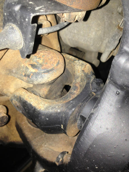

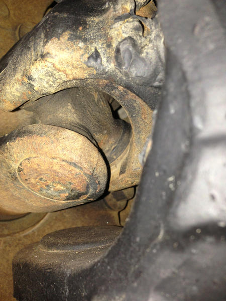

ok so I'm rotating my tire freely and I can feel the noise in the tire but when I put my hand over the ujoint I don't feel it as much. However if I quickly rotate the tire front to back I can feel a very very small amount of play in the joint against the axle. Also, the noise isnt as predictable as when im driving. I also got a couple pictures. Could it be anything more towards the brakes?
Also if I hold onto the draglink or tie rod I feel the clunk as well.

Sounds like a u-joint to me.

There should be absolutely no play in the u-joint on the axle shaft.

That's your ujoint

Jeep is at the dealership being fixed under warranty. Figured I'd give it a shot to save myself a bit of work and they actually covered it. Will post back soon with an update.
