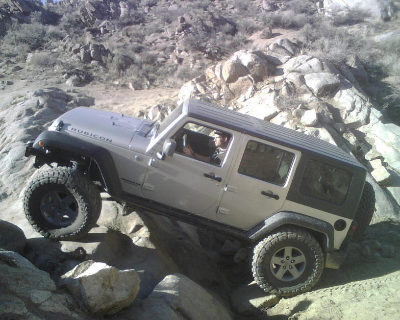

I'm running 37x12.5x17 BFG MT's on the stock Rubi wheels. I am running Spidertrax spacers for clearance. I love the stock wheels and couldn't find anything I liked better aftermarket. The narrowness of the wheels also allows allows more of a cushion when airing down as the tire is less likely to pull off the bead. In more extreme terrain I generally run 10psi front and 8psi rear and have not slipped a bead or spun a tire on the rim.

nice pic, how big is your spacer?

I'm running 37x12.5x17 toyo MTs on the stock Rubi wheels. I am also running Spidertrax spacers. I still rub a bit on the frame when I am at full turn.
