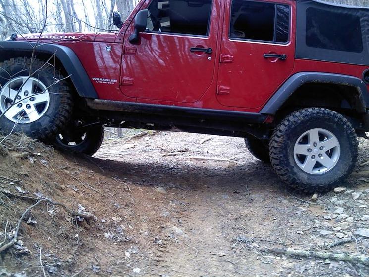

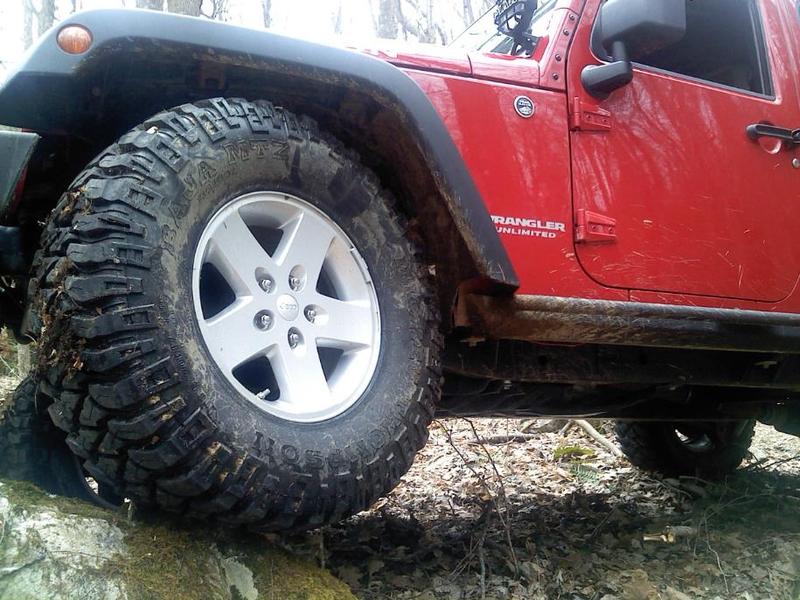

I have 315 70 17 on stock wheels with 1.25 spacers... you need spacers on 285 as wheel (they will rub your sway bar if not)
The big think you need to know.... 35/12.50/70 is the same height as 315/70/17... but the 315/17/70 is only 12 inches wide.... works much better with stock wheels...

Originally Posted by jcrcan25
I have 315 70 17 on stock wheels with 1.25 spacers... ... but the 315/17/70 is only 12 inches wide.... works much better with stock wheels...
nice pics...
so whats your lift? 2.5"?
305 would be 11.5's then......im only on HD stock susp....

Originally Posted by DanieltheManual
nice pics...
thanks... its a rough country 3.5 lift....plus 2 inch pucks up front to level out the dumb rake put into 08's plus the weight of the winch... not sure on 305's.. I know the 285/70/17 are 11.25 i think.... btw....got a barely used set for sell!!
