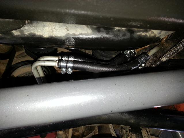

Originally Posted by ronjenx
Cut the crimps off. Install some rubber transmission lines. Double clamp each end.
This is how we rebuild these at the transmission shop I work

Well I got done cutting off the aluminum caps on mine (not in warranty anyway). New Jegs line and fuel line style clamps. I used the existing barbs on the end of the hard line as seen in the pics back a page. I'll keep checking on them and report any issues.
Nice job let me know how they work out. Have the same issue with my 09 out of warranty. Doesn't leak too bad yet but there is evidence that they are leaking. You wouldn't have a list of all parts needed and how to do this would you?

111555-16047 3/8"FUEL INJ. HOSE CLAMPS
6.996.9911555-60355 TRANS COOLR HOSE3/8"X10'
19.9919.9911816-30604ATF C+ QUART11.9511.95*
Parts I used from jegs.com
The alum caps came off like the guy on page 1 shows. Needed a small dremel. A flex cord neck helps. Then just dont cut too deep and use a flat head screw driver to open them up.
