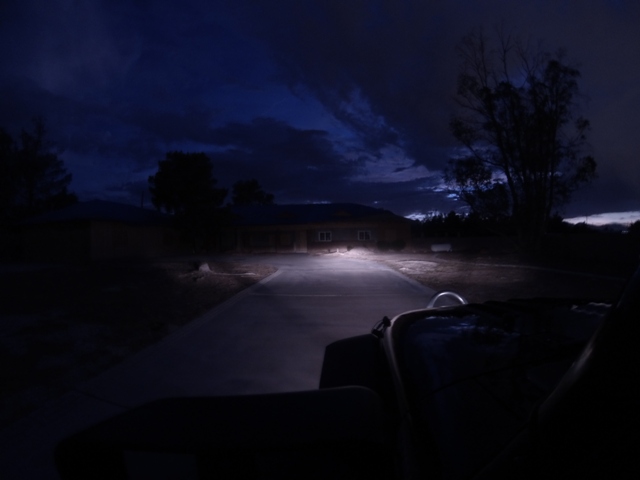

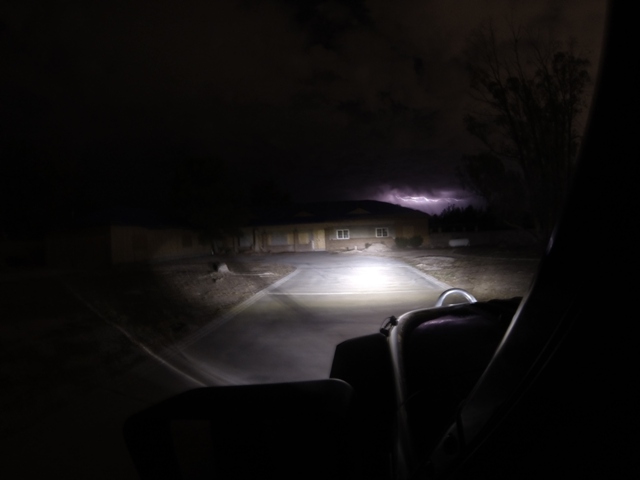

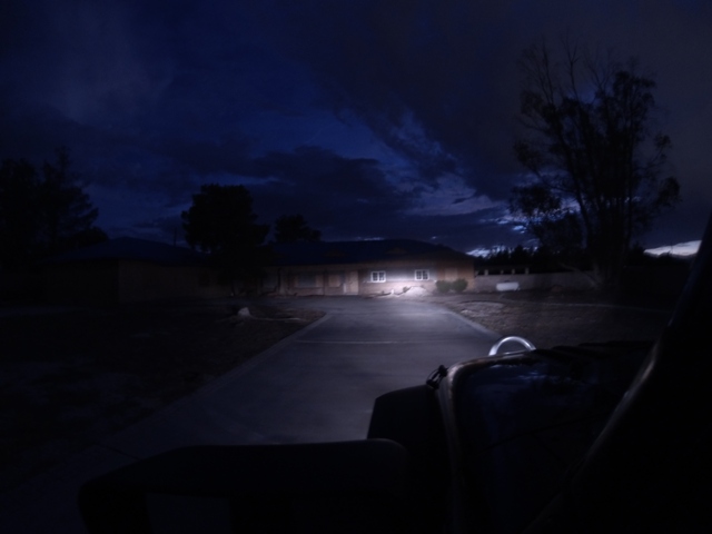

Has anyone looked into any other type of LED conversion kit other than truck light?
I found a conversion kit from a local supplier and thought I would try it out. for 160.00 versus 500 or 399 (when on sale) for truck lights I thought I would give them a try.
They replace my stock bulbs and were a good fit into the lens.
I have had them in my JK for a week or so now and they are bright as hell!! now I see why everyone raved about the truck lights!!!! LED's ARE BRIGHT
SO here are some before and after pics.
Post up if you found anything like this. I was kinda unsure how they would work out due to cost. but seem to be working just fine so far.
I would really like to find a set of truck lights and put them side by side. I think the truck lights will be brighter. but its hard for me to cough up the 150 more for them. Only time will tell how long they last.
First pic is Low beam stock, Second is high beam stock, Third is Low beam LED.Click image for larger version

Those look like they throw light up too high, maybe blinding other drivers. Or is the picture playing tricks?
I had to adjust the light downward some. I had my wife drive at me with them on and adjusted until they did not burn holes in your retina.
