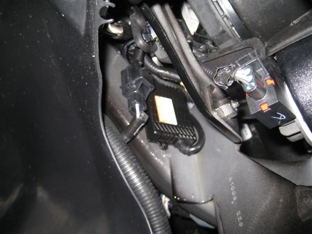

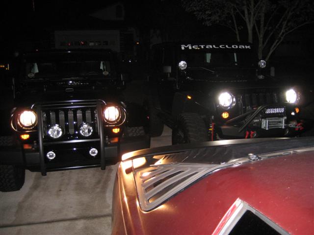

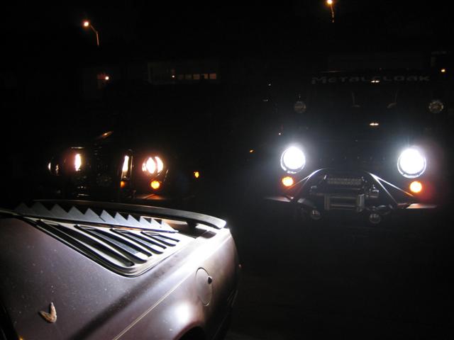

I'm very happy with them. There are those who say you can't put a LED in a stock housing because it could blind people but I think if you adjust them properly this is not an issue. I do not get flashed by oncoming traffic, they are WAY brighter than the stocks, and they are DOT compliant. Therefore, I have no regrets.

Aimed them lower. If you look at the third pic, which is right after install and before adjustment, they are WAY high. My wife's Sahara on the right was a lot lower. I cranked the screws using my wife's light pattern as a guide. Even though mine is lifted, I still brought them down to her level. In FL they only have to be 3" lower than the center height of the lamps at 25'. Which means lifted vehicles can be more blinding than non-lifted vehicles. Some states you can't do that. Since I travel state-to-state sometimes, I just brought mine down to hers. That's plenty of light for me.

Gotcha, thanks. Definitely a bit higher compared to stock height.
