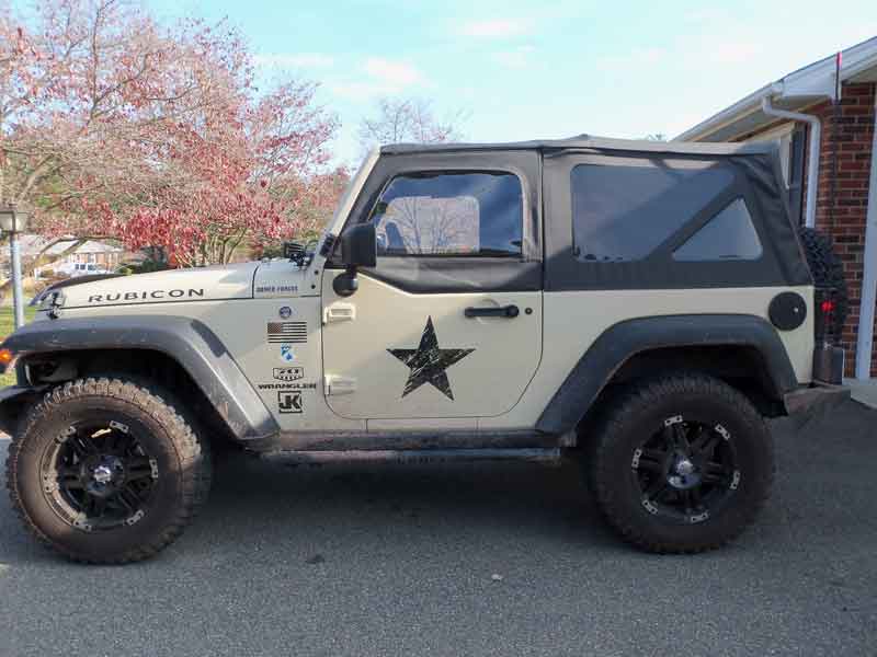

I don't plan on getting larger tires or new rims. I didn't want the tires to look too small. Just wanted to level and slightly lift, so I installed Teraflex spacers. 1" front and 1/2" rear.
On my Rubicon, there was only 1/2" height difference between the front and rear. I leveled the Jeep and added 1/2" lift. I am happy with the look and the little extra clearance.
