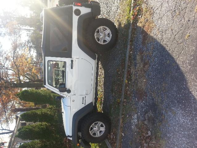

joefro's Avatar
Joined: Oct 2013
Posts: 41
Heres what im working with now

2dr or 4dr? I have a 2.5 tearaflex level kit on my 2 dr and I'm saving up for a actual lift kit same height the leveling kits give you a lifted stance and more ground clearance for wheeling and look great... But do make your ride a little stiffer then stock where is not an actual lift kit it does affect the ride quality... But if you at goin for looks and a little more ground clearance then its worth every penny

Mines a two door and I assumed is lose some quality because I had one on my truck before I put a lift on it do you have any pics?
