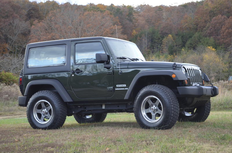

2011 jk sport 2" teraflex front 1" rear with 285 75 17 nitto terras 34" rides like stock. love it
<img src="https://www.jk-forum.com/forums/attachment.php?attachmentid=510759"/>
You can run 34s with just the leveling kit with no rub?

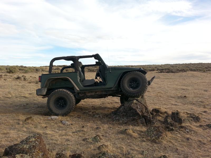

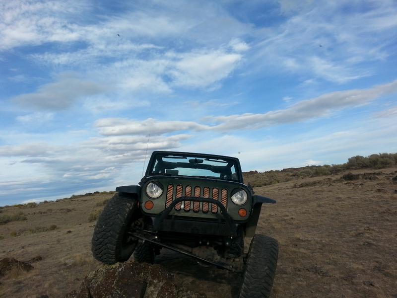

I tun 35s, no rub at all. Swapped the sport coils with ones from a 4 door Rubi and cut my fenders. Coils cost me 60 bucks and gave me 2" of lift. I did pick up some aftermarket shocks. Money saving way to go till ya get a real lift

No issues with this set up and I play fairly aggressively with my jeep

Was 60 bucks for the coil swap, if you found some rubi take off shocks be around 120. It leveled my jeep too, no more rake

Trimming the fenders is free

Buy some take off coils either 18/59s or 19/60s (19/60s kinda hard to find) and some Rubicon take off shocks. Should be 120 bucks or less, throw em on and 33s will be fine. If you want 34 or 35s trim the fenders and you'll be set. That's my set up, was very cheap and does amazing wheeling
