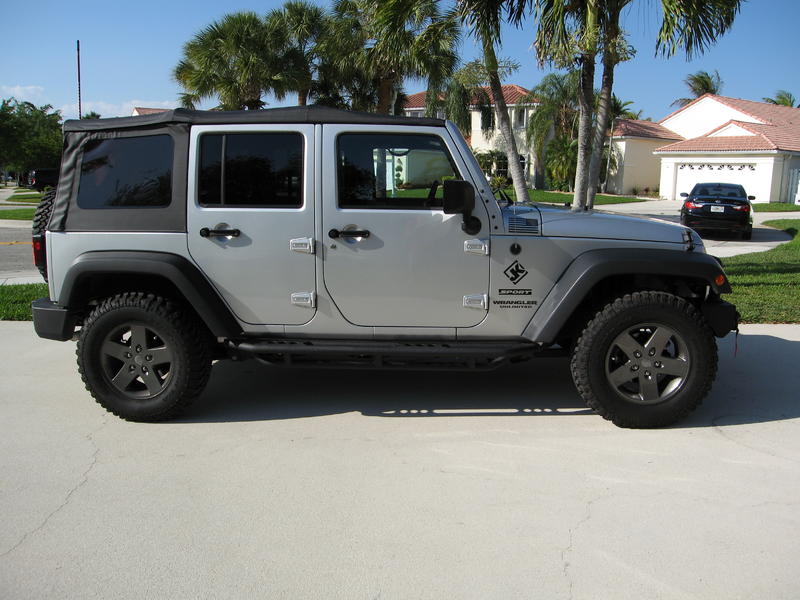

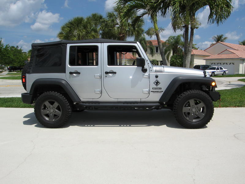

Some advice for the install, get a big ass crowbar. I had to use a 36" bar to put the springs back on and it was still a bitch, better yet get a spring compression tool, you can get them at any autoparts store, Sears or Harbor Freight. Trust me, it will make the install much easier. Below are my before and after pictures
Before
After
