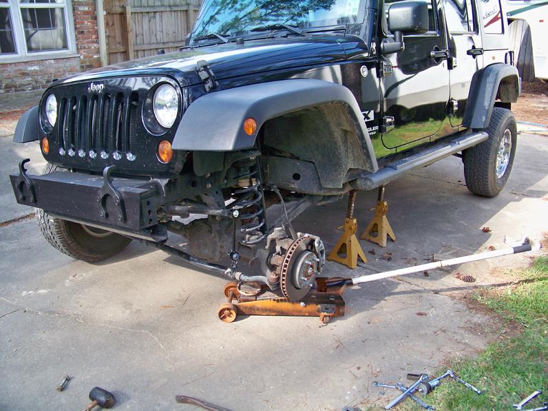

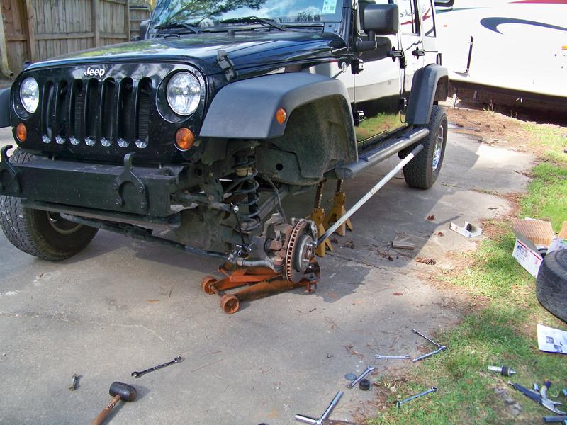

As promised here are before and after photos of the teraflex leveling kit installed. I don't think the photos do it justice. The difference when you walk around it is awesome.
Kinda like photos of the Grand Canyon are never impressive once you've been there AND after photos have the added weight of the hardtop.
I did the install alone in about four hours. I took my time doing it one wheel at a time and making sure that the jackstands were very secure.
I'll put some more install photos below.

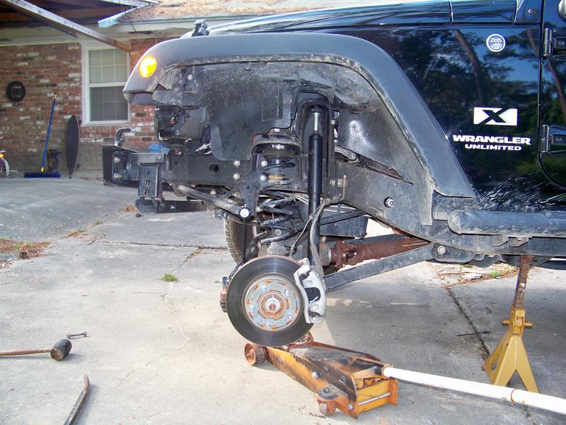

Old Apr 9, 2011 | 10:28 AM
  #24
Notakar's Avatar
Posts: 612
From: Mandeville, LA
Here we go
Photo 1 - Full flex disconnected. You will note the shiny shock extension at the top of the shock. This was not a part of the Teraflex kit, but was purchased with the setup from Derek. It appears the shock is the limiting component here. I double checked that the brake line wasn't stretching.
Photo 2 - Another angle of full flex disconnected.
Photo 3 - Full flex connected. Note the DIY quick connect (Clevis Pin). I'm not sure if I'm going to run it full time or just when i know I'm going on a ride. I'll probably leave it on for a while and check the wear and tear over time.
Photo 4 - 1/2" by 3" Clevis Pin. I used 7/16" fender washers instead of 1/2" because they are a better fit around the pin. Two full sets (4 pins, 8 washers and 4 clips) for under $20. I'll keep the spares in the JKU.

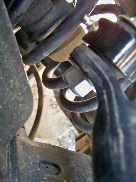

Photo 5 is the upper bolt on the swaybar links. Does it look right Derek?
Time to test it out

I dont think mine had excess threads sticking out either. you might want to flip the swaybar links though. They are kinked to compensate for the gap between swaybar mount and axle mount. If you spin them 180 degrees, they will fit a little better. I would also put the washer between swaybar and bushing as opposed to swaybar and nut, less wear and tear over time.

Got ya Now i remember seeing the "kink" when it came in. That explains the drivers side looking like it's loaded when it's not.
Edited 5 minutes later: - Thanks Just got back from switching it - looks good.
