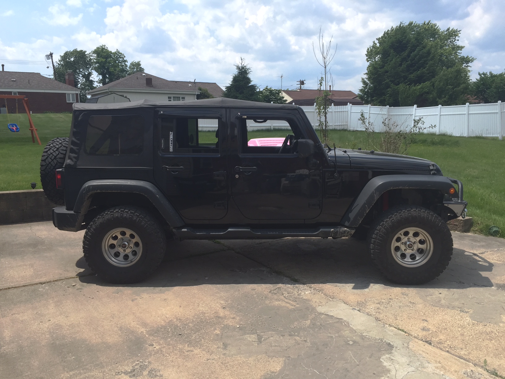

Ok i guess i should've made myself a little clearer. I understand it's still a lift. i just didn't want a full blown shocks, coils and about a $2000 price tag lift. Just looking for something
simple but effective. I am aware 275 and 285 is the width, but from what I've read any more than 11" wide may rub. the height on the 285 is about 32.7" which i don't think is a problem.
As far as the back spacing i was thinking no more than 5".
I will definitely read those two threads. Thanks
$2,000 ?
I did the Rubi Express 2.5" lift this past weekend. $380 out the door. Level plus a little more.
~5hrs with beer breaks. Easy to do with some jack stands, jack, wrenches, and sockets.
Rancho 5000X a month or so ago @ $200 - $50 rebate
The ride is so much better than before.
I was torn between lift or level. The install process is exactly the same... so rather than level now and lift later, just lift now and be happy. And if I want to go from 33 to 35, i'm all set.
