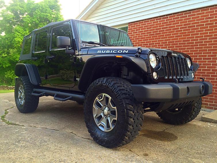

Hello All! I'm new to the forum and somewhat new to Jeeps. Members of my family have always had Jeeps and I've helped work on them, but this is the first time I've owned one myself. I have a 14 Rubicon JKU 4 door with only 12,000 miles. Spacer lift, 35" trail grapplers, N-Fab steps and Bushwacker flat fenders. Bumpers and wheels are coming soon!
Anyways, I am not happy with my current spacer lift kit. It was already on the Jeep when I bought it. The Jeep tends to "wander" while doing 60mph+

Picture of my Jeep:

Welcome to the forum. Maybe consider just getting lower control arms or some control arm drop brackets to adjust the caster. This will likely fix your situation. But if your not set on that then look at the RK 1.5" lift, or the AEV lift. You look around 2.5" of lift right now. People who have the AEV rave about the on road ride quality so that may be a better option for you and since money isn't a concern then maybe look at them because they are a little higher.

I second the idea of keeping what you have and adding front lower control arms or the AEV correction brackets. Your issue is likely due to low caster. If you get a suspension lift, there is a high probability that it won't ride as nice and that you have additional issues that will have to be dealt with - especially because most lifts give more than the advertised lift. Keep it simple and you'll be happy.
Might also check the toe on the front axle. That also could be the cause of the wander. It most definitely is not due to the lift components though.

Why drop a thousandish on springs when all you need is to fix your caster? Adjustable lower control arms or drop brackets are all you need. Get caster angle above 4 and below 6. Your building your jeep for street so a spring lift is overkill.
