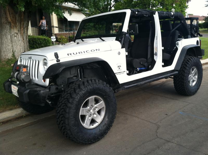

LIFT: Full Traction 3" Premium Plus
SHOCKS:Bilstien 5100
SYE/CVD: No
TIRES/WHEELS: For purposes of this review stock Rubi (Just moved up to 37's but ran it for a year on the Rubi stuff)
Likes: Rugged, Crazy Flex, Quiet, works at speed for open desert stuff. Made in USA. Good Ride
Dis-Likes: Should have come with front lower instead of upper arms. HAVE TO HAVE 4 1/2 backspace wheels or spacers or the rear swaybar links will rub.
Would You Recommend:Yes
Picture(s):
ETA: Forgot about the backspacing.

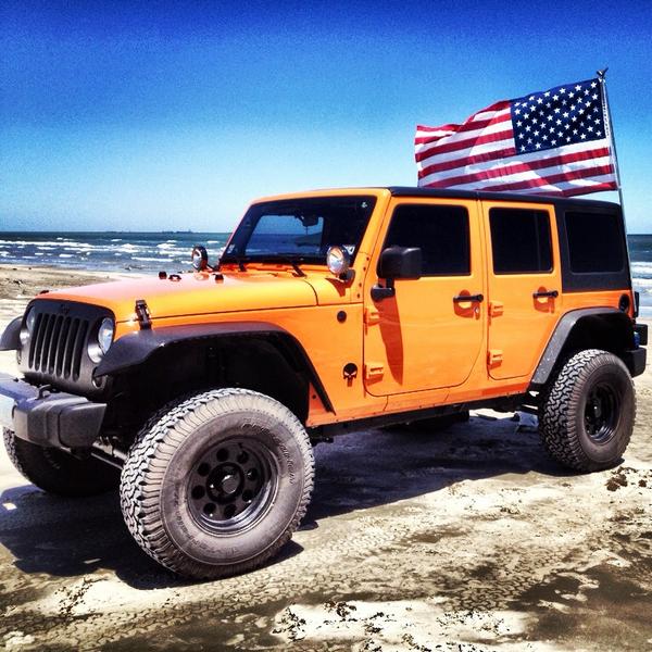

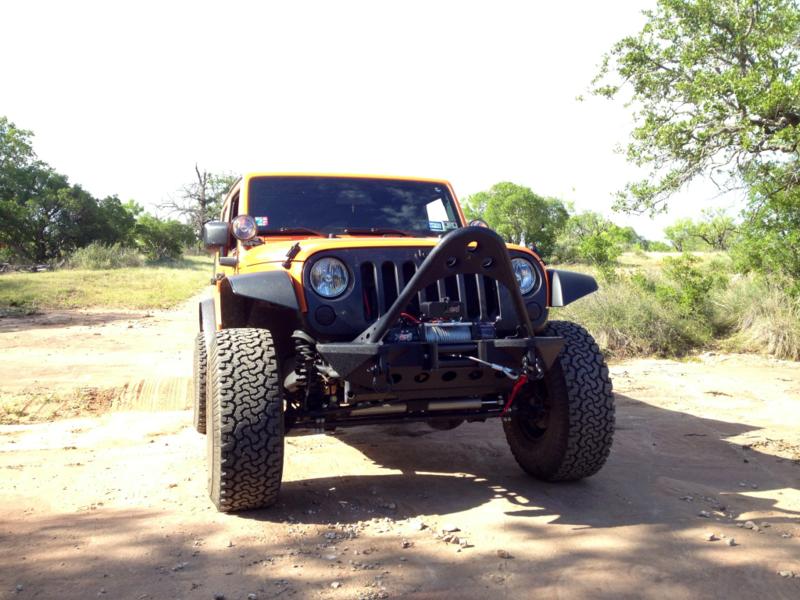

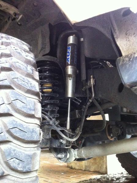

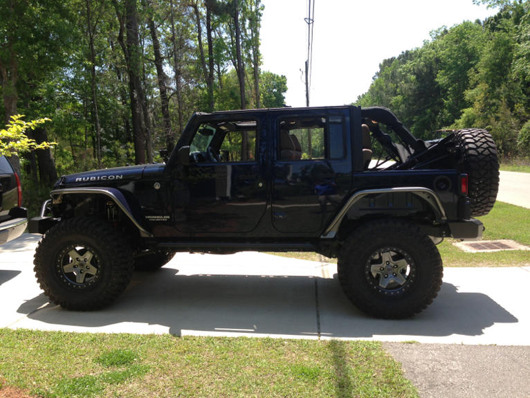

LIFT:
Full Traction, 4", 8 arms
Full Traction CRC Link
SHOCKS:
FOX + reservoir
TIRES:
Mickey Thompson MTZ 35” (actually 34”), 315/70/17, Load D
DD - 30 psi. Offroad - 14 to 25 psi
WHEELS:
Pro Comp 7105 Xtreme, 17x9
Likes:
Very well made and good articulation.
Relatively soft, smooth & completely quiet.
The Full Traction CRC Link made a meaningful steering improvement.
It replaces the rear radius arm, and eliminates the sideways movement of the axle, so the need for constant small steering corrections has disappeared.
This improvement is quite noticeable both on roads and offroad.
A side benefit is that it also serves as a shield for the rear differential.
Link - Full-Traction Suspension | Jeep JK CRC-Link Conversion Factory Axle
Video - http://www.youtube.com/watch?v=dJNpS63N7Ao Dis-Likes:
None.
When running wild - sprinting - I sometimes hit the bump stops... Not a true complaint, as the suspension is tuned for slower obstacle crossing and not for offroad speeding or jumps.
Better bump stops will take care of this (Haven't decided yet if FOX or TeraFlex).
Yes
Picture(s):
SHOCKS:
FOX + reservoir
TIRES:
WHEELS:
Likes:
None.
Yes
Picture(s):

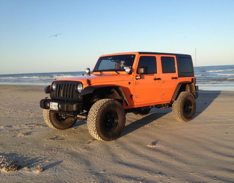

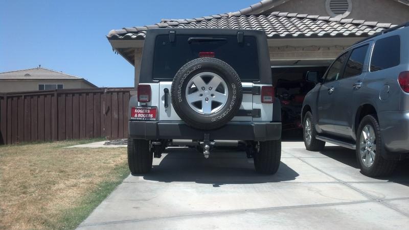

Does this count? It's not an actual "kit"
LIFT: Teraflex 1" front leveling spacer
SHOCKS: Stock Sport
SYE/CVD: No
TIRES/WHEELS: Stock with 1.5" PSC Spacers
Likes: Rides like factory while looking beefier, Cheap and easy to do yourself, gets you by until you can afford a "real lift", allows for 33x11.5 or larger tires when I can afford them
Dis-Likes: Doesn't give you any more travel/flex
Would You Recommend: Yes, for less than $200, I am very satisfied with it's capabilities until I have the coin to do much more.
Before:
After:
SHOCKS: Stock Sport
SYE/CVD: No
Before:
After:

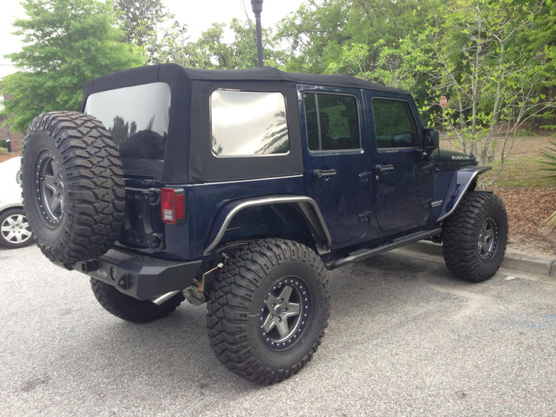

Lift: metal Cloak 3.5" gamechanger. 3-4" daystar spacers
Shocks: MC 6 pack
Tires/wheels: Mickey Thompson Baja MTZ 37-12.50-17, AEV pintler beadlocks
Review: this is hands down the best on road lift kit I have ever driven or ride in. It truly does handle better than my buddy's Sahara on rubi take offs. The little bit of flexing I have done have been great. Will test it thoroughly soon. The shocks have more down travel than anything short of coil overs. I am sure that the offroad performance will match the on road performance.
Likes: complete kit. Everything you need with good instructions. Most potential flex available on the market excluding coil overs. Best kit for a DD.
Dislikes: not sure why the rear sway bar gets relocated. Can hit muffler on large bumps. Will have to replace muffler with smaller unit.

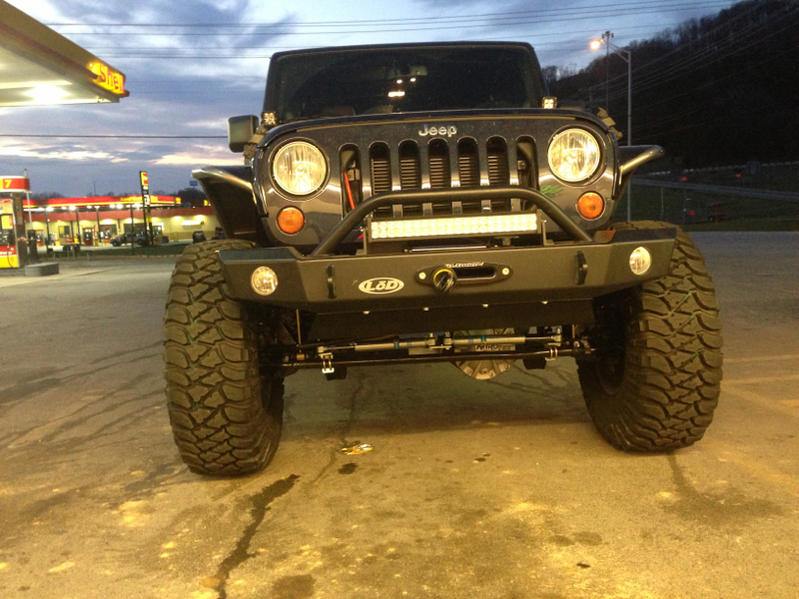

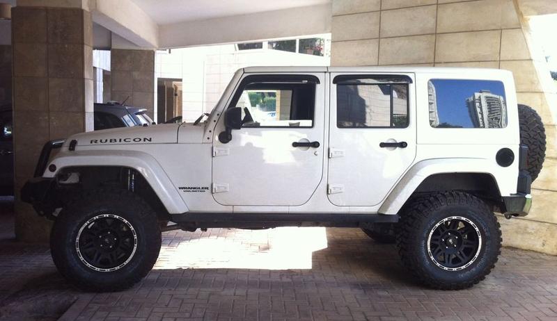

LIFT: 4" SkyJacker with Lower Control Arms
SHOCKS: Pro Comp
TIRES/WHEELS: 315/75/16 BFG AT KO's mounted on MB 72's
Likes: the stance is perfect and articulates pretty well.. The price point was good.. Overall a pretty good package
Dis-Likes: experienced road wandering at highway speeds so I have had to throw a little more money at it to get the steering geometry right. The front end sagged about 1.25" after adding a stinger and winch.. Spacers on order
Picture(s):

SHOCKS: Pro Comp
Picture(s):
