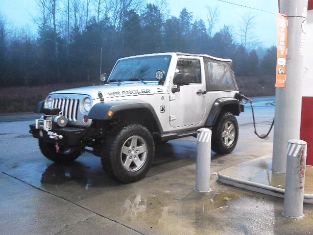

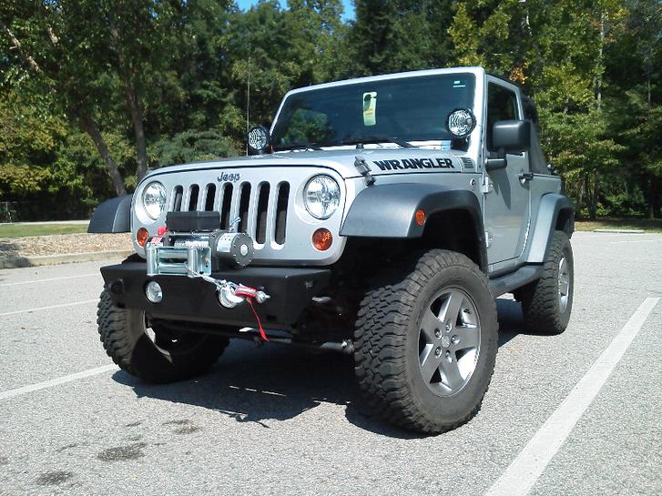

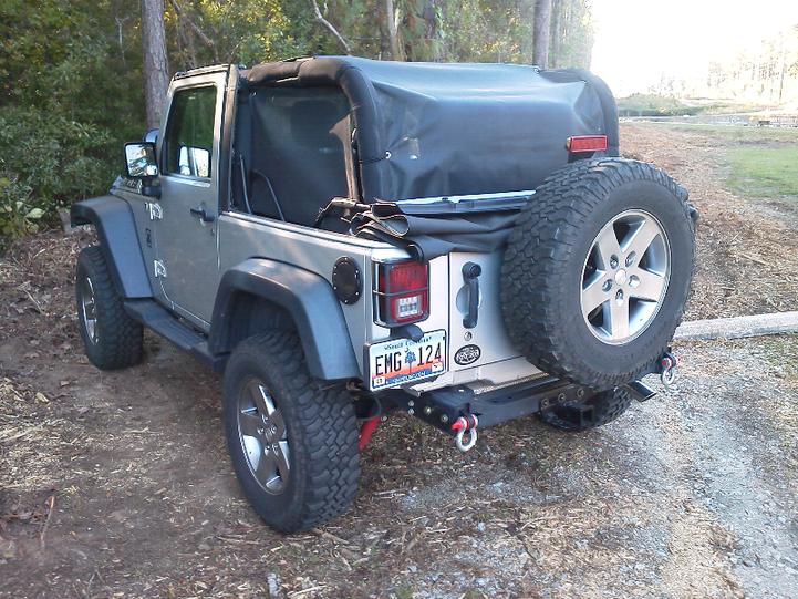

Same JKU springs as you with the addition of TF 2" in front and 1" in rear spacer leveling kit. Very happy. I do not do heavy wheeling just service and logging roads. I am thinking about longer brake lines down the road. I also run Rubi shocks as well. No issues.
