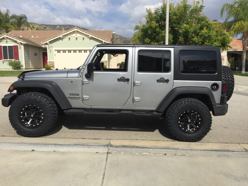

So I got my tires and wheels. Thought I had it all planned out but now that the tires are on I feel like I NEED to go bigger. So let's here some suggestions on how much lift I should go with. Originally I wanted to go 33's and a teraflex 1.5" (2 in front, 1 in rear) leveling kit. The tires are nitto trail grapplers 295/70-17 wheels are XD Addicts 17x9 with 4.5" back spacing. They rub slightly before full lock. The tires official diameter per NITTO is 33.5". Will the 1.5 level kit even help here? Post some pics if you have them.

Wrangeler X's Avatar
Posts: 659
From: Channahon IL
You need wheel offsets to keep the tires from rubbing.

What area they rubbing on?

If it's just the plastic air dam that can be trimmed.

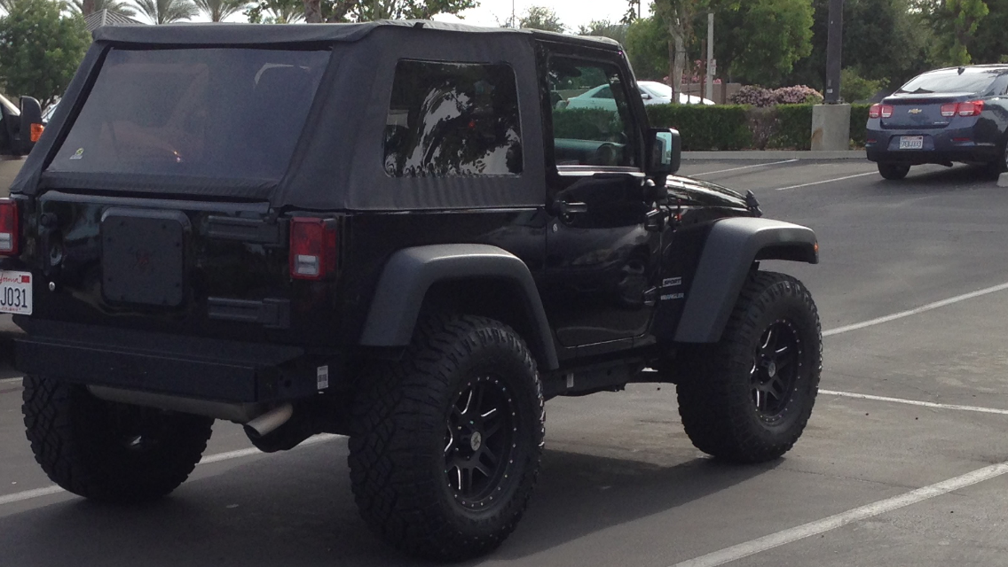

This is a Teraflex 1.5 spacer lift with 315/70/17 Duratracs, but replaced heavy hard top with soft, removed rear seat and spare that reduced weight in rear by well over 200 lbs

are you saying I should add a spacer to my wheels?

if ur kit raised it up by one in the rear yours looks like it went up more than that. Line looks like one inch wouldn't even help. Or my 33's are huge.
