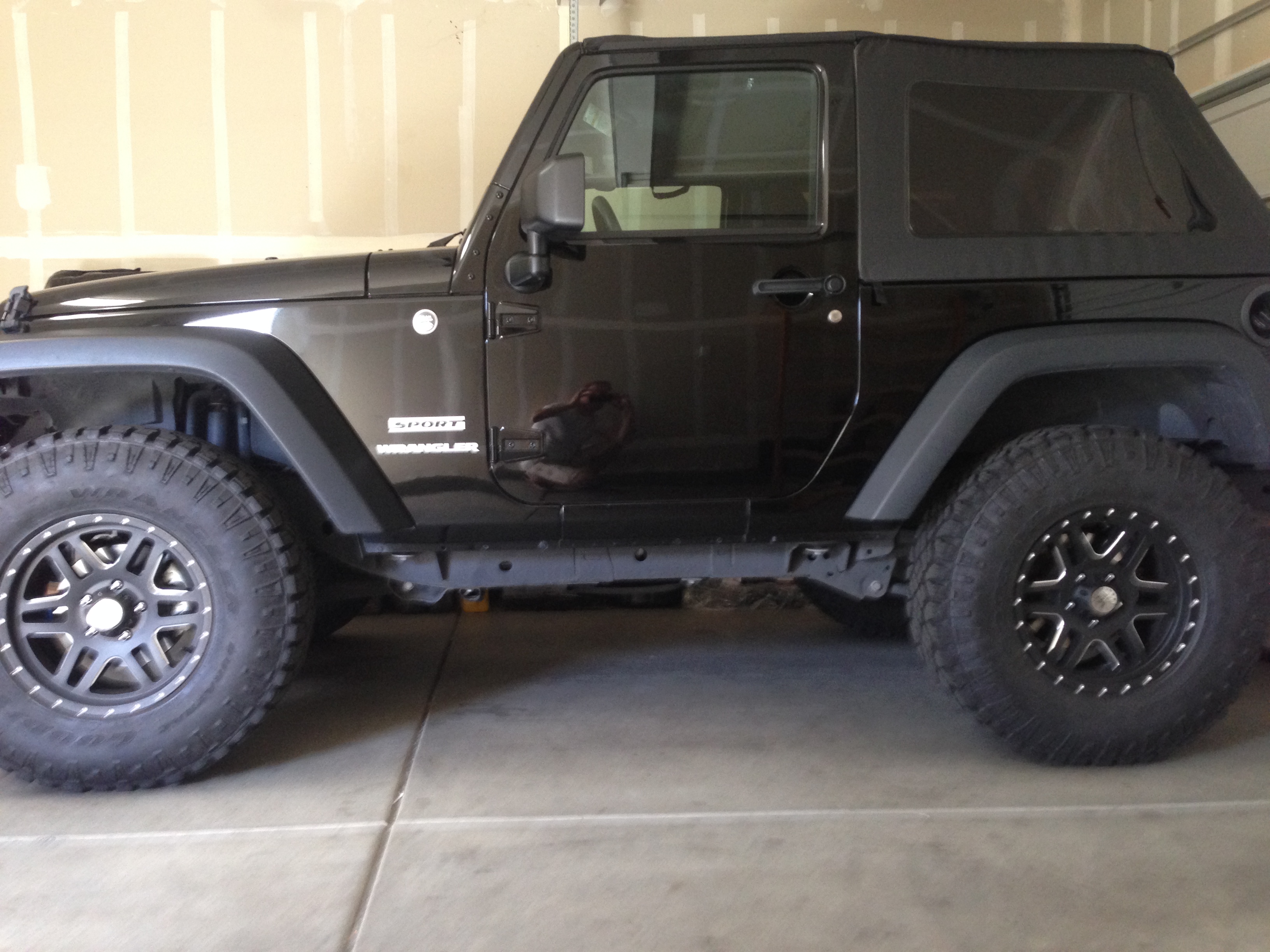

Would the teraflex 1.5 level kit be very capable. Like I said not looking to rock crawl but don't wanna puss out on mild/moderate stuff
Old May 21, 2016 | 09:44 AM
BFGMallTerrains's Avatar
Joined: Nov 2015
Posts: 171
From: Fresno
Yes. Here's mine with bigger 315/70/17 Duratracs
