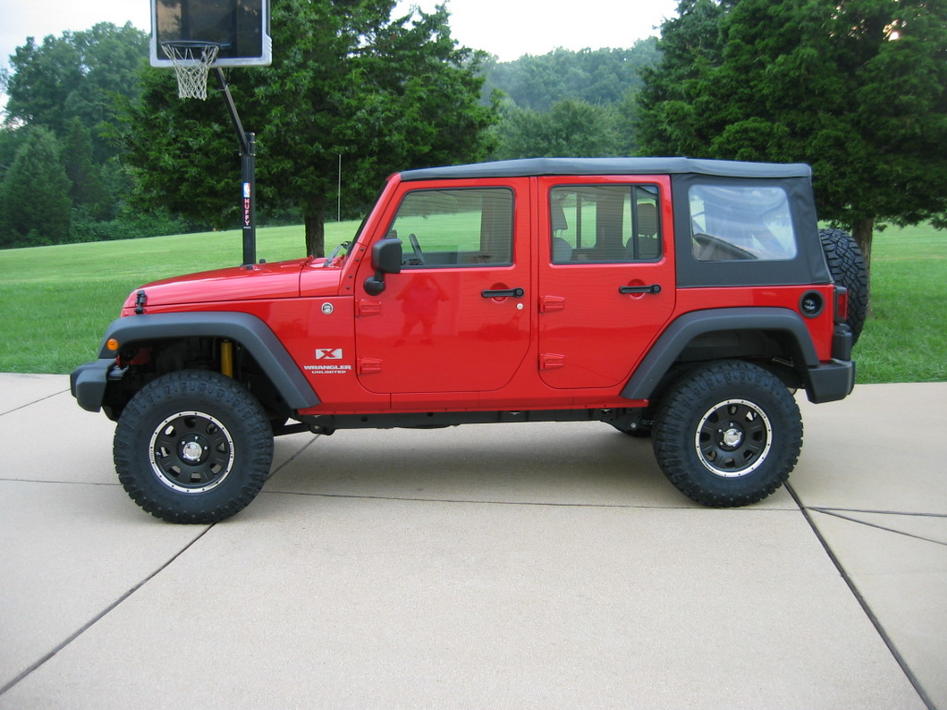

Here is mine with the 2.5 TF coil lift. I'm running 33's with lots of room to spare; 35's will fit with no problem. I also added a adjustable front trackbar just because I didnt like the front axle to be off center; it handles and drives as good or better than stock.

that dealer gave you bad info after bad info. I would find a real 4x4 shop that has worked on some JKs. The most you can clear on the leveling kit is 35". But you could prolly add some extended bumpstops and go 35s. Lots of guys on here are running the teraflex 2.5" kit with no issues. It fits 35s great, and levels the jeep out. I think your leveling kit is a good idea, just get propper wheel offset by using spacers or wheels and add some taller bumpstops.
Just for reference, I have the 3" teraflex kit. I have all 8 control arms and JKS track bars front and rear. Shocks are ome LT. I am running 35" mudgrapplers... pretty sure I could fit 37s.
I had a 2" spacer lift at first on my jk, and I had more esp/abs issues with it than my tera 3". My jeep drives straighter and handles better on 35s than most stock jeeps do.
