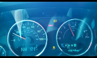

Recently, my 2012 JKU started having strange issue with dash lights. Basically, while driving down the highway around 65 I was hearing the jeep warning ding, but couldn't figure out where. Finally, I caught multiple lights (ABS, Traction Control, and Brake warning lights) lights come on at the same time. Additionally the speedometer would drop to 0 and come right back to 65 mph. I caught it happening on video too.
Anyone experience this on a 2012??

Here is a pic I grabbed from video. Keep in mind I am still driving at 65mph. Look at speedometer

Sound logical. Mine has been doing this on and off now for 2 weeks. It also appears to be getting progressively worse.

I just found this thread because I was about to post something similar...
Mine is doing the same thing (hill decent, ABS, traction control, and parking brake) with the lights and the ding, and the speedo drop.
It happens to me going straight, around left curves or right curves, going slow or fast - it's very random.
It just started a day after I installed Currie Antirock sway bar system on the front, so I assumed it was something with that? When I had my stock sway bar and JKS links on this didn't happen.
