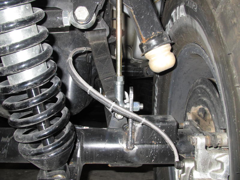

Where do they attach? Just wondering.

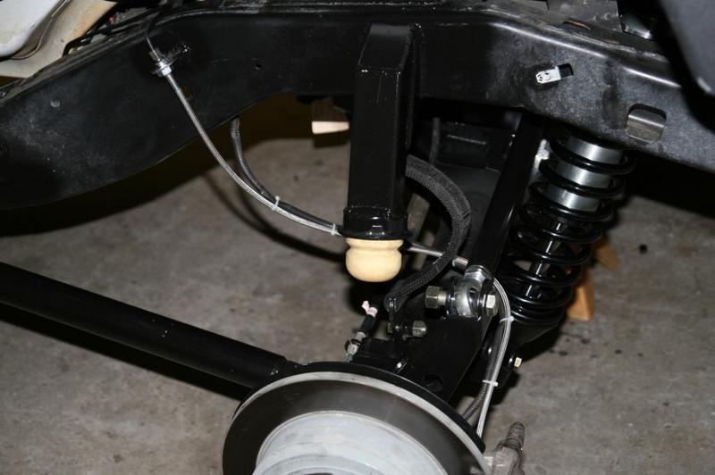

bottom of frame to top of axle

Is that bump stop rubbing the tire?
It doesn't rub at any point during the articulation,,,, even though it comes within about an 8th of an inch But yes,, it is a custom bump stop
