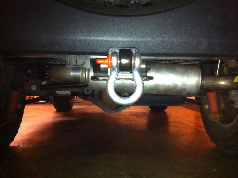

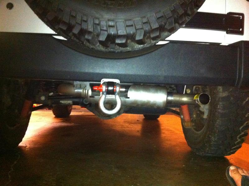

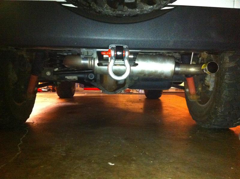

Thanks for the info. I'm not as worried about the sound as I am the fitment of the tailpipe and the look of the slope.
Here are a few (bad) pictures that I took when I got the muffler on. It was dark, and in my garage, but I think it at least shows somewhat of what I mean. You tell me if this is normal.

I will loosen stuff up and wiggle things around to try to re-align the muffler a bit. May just take it to a shop to have the ease of a lift and extra set of hands (my wife isn't going to be much help).
I am going to use an impact wrench on the clamp for the tip to see if it can get any tighter. I will definitely make a video and post it showing how lose it is later today or tomorrow.
One last (stupid) question... how do you suggest I get the paper labels off? They won't burn up if I just leave them on will they?

That looks a little extreme on the tilt of the muffler. That would annoy the crap out of me! I would loosen it and reposition it and then tighten it back up like I said before. It should be much closer to level than that.
As for the tip, contact user "dynomax" as he will have further details for you
