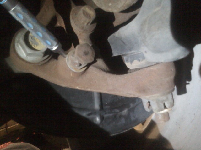

Originally Posted by Jeeptang
Post up some pics if you get a chance please
The mechanical pencil in the pic is pointing to the washer installed under the steering stop. Unscrew the stop, re-install with added washer, test for tire clearance, done.

Old Jul 30, 2014 | 05:11 PM
Jeeptang's Avatar
Posts: 337
From: Kansas city,MO
Worked like a charm. Thanks a lot. I splurged and got grade 8 washers. Lol cheapest fix I've ever done
