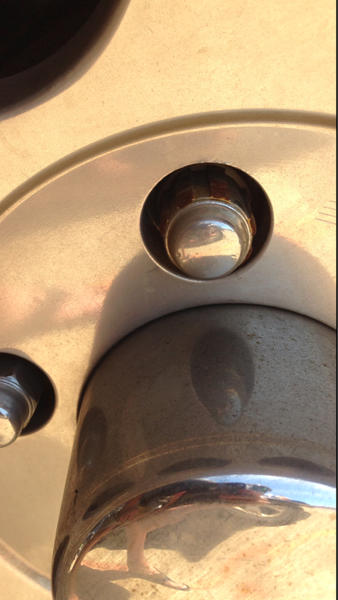

These locks came on the jeep but the key didn't. Has anyone used these, know how to get them off, or know what brand? Thanks
Not a very good picture, but from what I can see, looks like a standard gorilla locking lug nut I think they're called. Any tire place, les Schwab, discount tire, etc. Should be able to sell you one. I'd try les Schwab first, they gave me mine, then I went to discount for one for my ex girlfriend car and had to pay for it. No biggie it was only 12ish bucks I think.
They do kinda look like Gorilla's. O'Reilly's, Autozone, Advanced Auto maybe too? I'm sure a tire place would have a key and can take it off for you too.

Here is a better pic but no one had a key for it.. No auto parts stores or tire shops

As a last resort you can try to tap a 12 pt socket onto the lug. You will most likely have to replace the lug and the socket.

I lost my key once and had to weld a piece of steel to them and turn the steel with a pipe wrench.

Yes they look like Gorilla locks

Go to a tire shop they should have a tool to get them off without damaging the wheel.

There's a couple of brands, but may be Gorilla. They're "splined" lugs.
