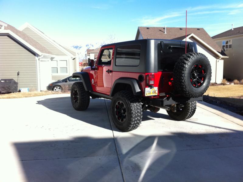

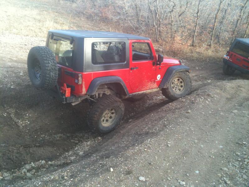

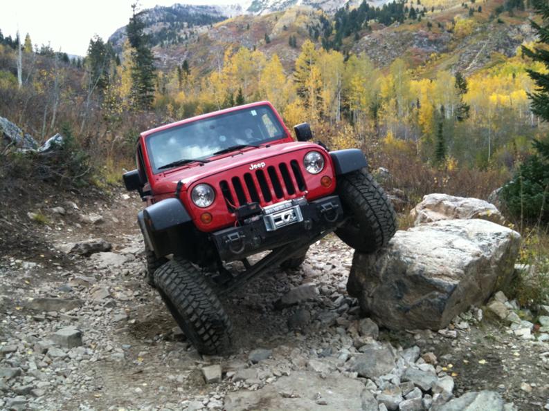

I was debating my self for a long time. Finally went with eaton elockers had em about a year now and I beat em up pretty good. I live in Utah lots of snow so it's nice to flip on flip off. And yes it's a full locker when locked. I love my lockers man. Many people on here will whine and cry and tell you how crappy they are but mine still work perfect no air lines to leak. I will never go anything else could t be happier.
