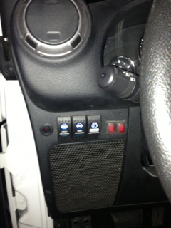

Mine are mounted above the driver's side dash speaker. There is plenty of room back there and the wires are easily feed throughout the rest of the vehicle, including through the firewall.
Edit: Mine is a '12

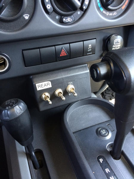

Since there are different interiors, it would help if we knew what you're working with. Even if you filled out profile info, those of us on phones can't access that. FYI, I put mine in my '07 initially to the right of the steering wheel column in some empty panel space. Now they are on the sPOD controller.
