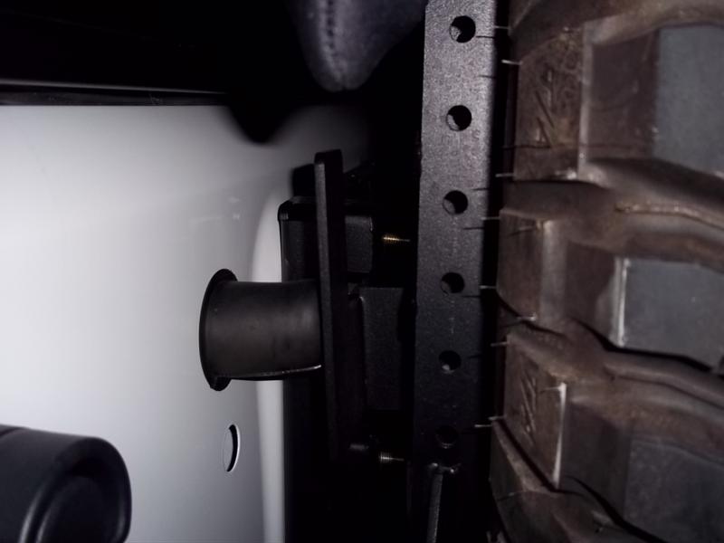

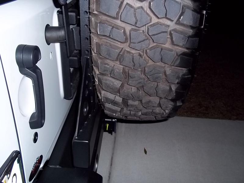

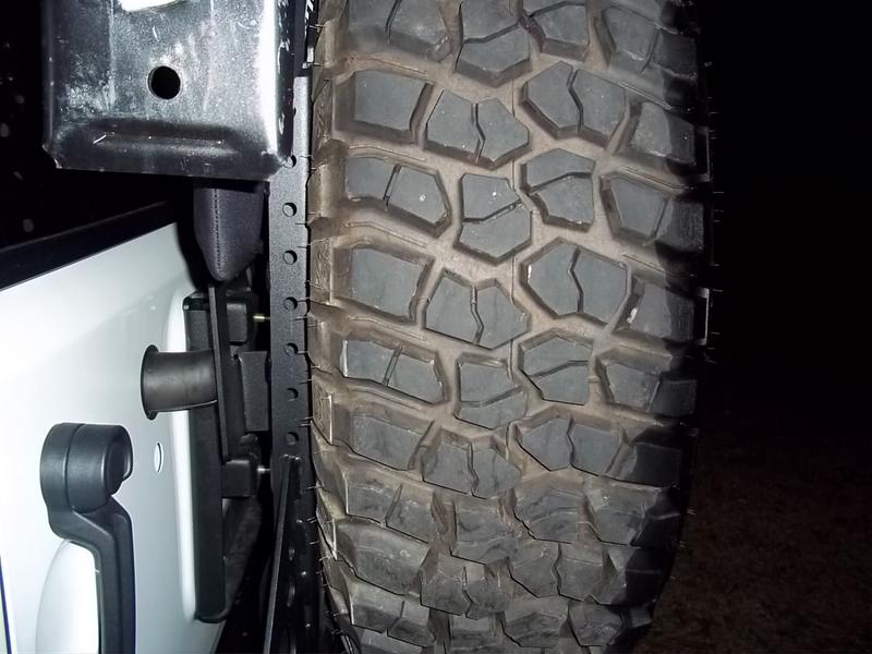

Installed the full width Gen 3 with tire carrier, fuel rack and light relocation. Goes on tight but fits well, An extra set of hands would go a long ways when installing. I used the forks on a front end loader which helped alot. Need to make sure the lights are good and tight with Loctite so there is no rattles with the light up against the bumper. You can not get to the lights once the bumper is installed. I wired the rear lights to a separate switch and installed a backup camera in the bumper below the reciever hitch. If I had it to do over again I would move the camaera to the side six inches so when the drop down hitch was in you could see the trailer tongue better.

The latch is ajustable so it holds tight even in rough terrian. It does not have a lock on the tire carrier at the latch and you would need to use a locking lug nut and tack weld the back of the nuts on the three tire carrier bolts. I did fashion a lock for the Hi-lift Jack from a reciever hitch lock that goes through one of the holes in the jack rail.
