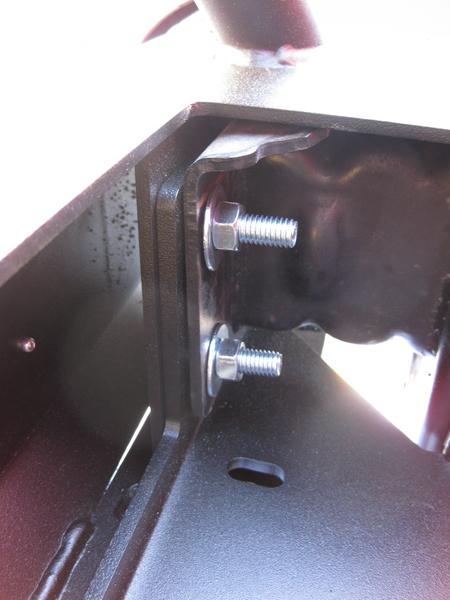

I just installed this bumper yesterday, and it was shipped with hardware already assembled on the bumper (I also had no instructions). There are 8 bolts, 16 washers, and 4 narrow plates that attach to the front of the frame. There are also 2 bolts, 2 washers, and 2 nuts (with welded stops) that attach to the side of the frame.
I'll have to check to see how the winch plate is mounted to the bumper, but if I recall correctly it's just the 8 frame bolts. I can always take pictures if it would help.
Wait! I did take one picture:
This is a bad picture because it doesn't show the installed narrow plate, which goes between the winch plate and frame. I can go out and take better pictures if you think it would be helpful.
Attachment 128134
This is a bad picture because it doesn't show the installed narrow plate, which goes between the bumper and frame. I can go out and take better pictures if you think it would be helpful.
Read step 2 (second pic of step 2) here to see what I am talking about, and it sounds like you did not get the hardware I am talking about either, BTW...
https://www.jk-forum.com/forums/show...Bumper-Install
Here is the install.
http://project-jk.com/jeep-jk-write-...ation-write-up
Disreguard step 2 that you are talking about, we havn't used those holes for a couple of years now. If you want you can put bolts in them but they are not needed. They are still programed in one of our lasers that cut the bumpers, so thats why they are there. Give us a call with any questions.
