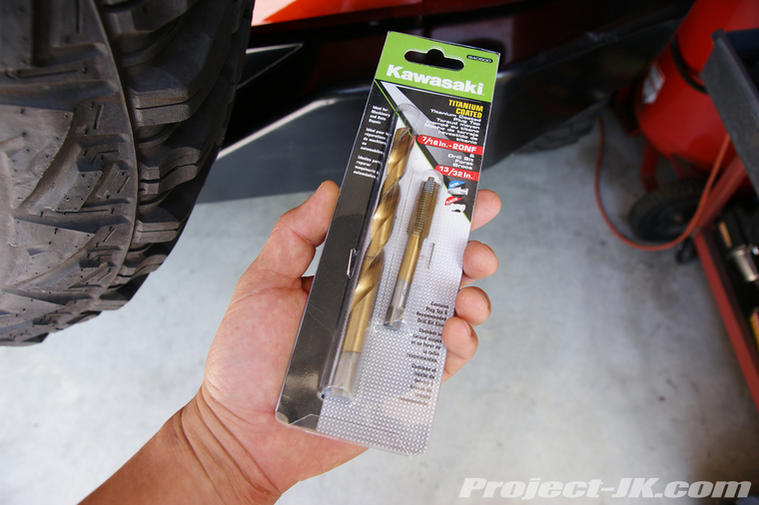

Why do the instructions from LOD say to use 7/16 and 13/32 - 20?
Well, let's look at the math.
7/16 = 28/64, so a larger hole drilled.
13/32 = 6.5/16
Larger hole and smaller tap. No idea what they're thinking, but that doesn't sound like a good idea. Tap will probably go right through the hole. You can find drill/tap charts online to confirm. Pretty sure that combo doesn't work.

I am most likely reading this wrong; I'm pretty new to this. But here's what the instructions say and the accompanying picture:
"12. If you don’t have one already, you really need to pick up a matched 7/16″ x NF20 Drill Bit and Tap Set like the one shown here.

Originally Posted by jdschup
I am most likely reading this wrong; I'm pretty new to this. But here's what the instructions say and the accompanying picture: "12. If you don’t have one already, you really need to pick up a matched 7/16&Prime; x NF20 Drill Bit and Tap Set like the one shown here. <img src="https://www.jk-forum.com/forums/attachment.php?attachmentid=581217"/>
Correct, that's the tap size. Corresponding drill bit is 25/64. That set they picture has been coming with the wrong size drill bit. Just double check.

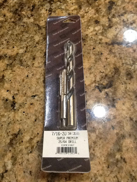

This is the size I used, worked perfect.
Attachment 582287
Where did you get that set? I'm going to be putting these on soon and need to get all the tools lined up for a smooth install.
I got mine from Lowe's
Old Jan 4, 2016 | 03:22 PM
  #47
kfxbryan's Avatar
Posts: 205
From: ruther glen va
Fastenal.
I have the 7/16 20 Tap on order. Is this the wrench I need? Klein Tools 68310, 5 1/2-Inch Ratcheting Refrigeration Wrench - - Amazon.com I'm probably going to buy that if its the right one. Also I'm thinking about just Drilling tapping and bolting like 2 on each side. Just to get it on then weld the rest. If I ever need to get them off I can just cut them off. Maybe I'm just lazy but Drilling and tapping 14 holes does not seem like a fun time. I'll have to see how the first holes go then decide if I want to do the rest.
I think once you drill and tap the first couple of holes you will see it is not that bad. I worried more than I should have and it ended up going smooth as silk. Just use cutting fluid when threading and you will be fine. Good luck with the install.
