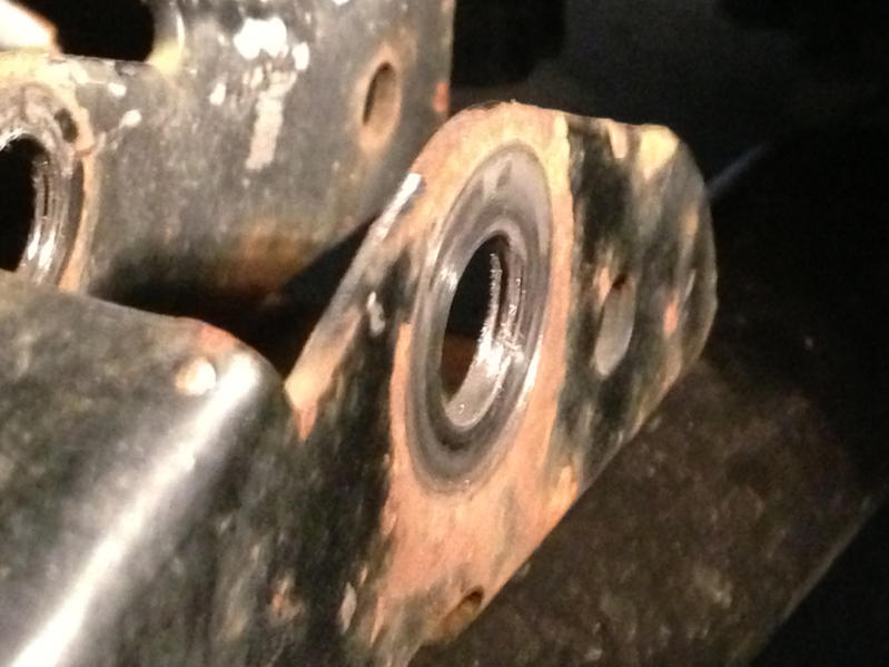

Old Jul 31, 2013 | 11:02 AM
RDakota's Avatar
Joined: May 2008
Posts: 230
From: Sioux Falls, SD
Steering column replaced, no change. I rotated the tires on Sat, no change. I removed the stock bolt on the axle side of the trackbar. The holes in the trackbar bracket looks to me to be ovaled. I have attached a picture. I also took a video of the bolt moving up and down in the bracket holes. (Can't seem to attach a video from my phone). It moves quite a bit. Service manager said he is not concerned with this. If the bolt is torqued, it won't cause a problem. I'd like to get the opinion of others that know more about this than I do. Is this right? They are going to adjust the steering gears tomorrow. They say it is bump steer. Does this make sense? Thanks for the help.
