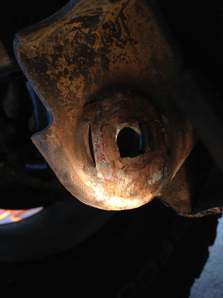

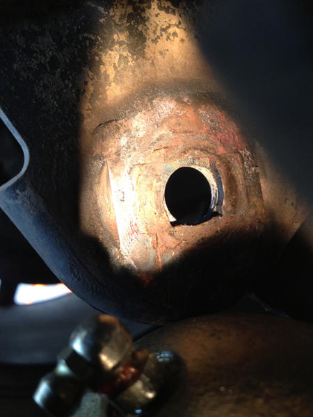

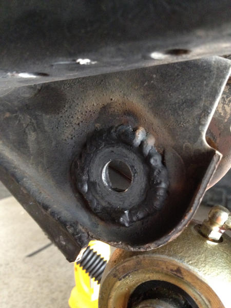

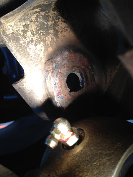

Correction **front lower AXLE control arm hole**
Pics for the non believers. First 3 pics are of the inside of the front lower axle control arm mount. The last pic is the washer welded to the outside. You can see the hole was not round but elongated with rounded edges. Exactly like the OP posted.
Attachment 353885
Attachment 353886
Attachment 353887
Attachment 353888
Unless my monitor is some how distorted, your pics look nothing like the OP's.
I don't believe I said "here are pics just like the OP" I am trying to show that my mounts WERE exactly like the OP BEFORE I welded the washers on. Since I welded washers on I had to take a pic of the INSIDE of the control arm mount, to show it was not round from the factory. I was saying mine was not round "exactly like the OP"

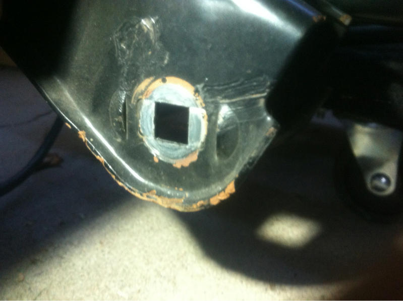

Slotted? Lol

Originally Posted by matzjeep
Slotted? Lol
This is exactly what mine had looked like before the grinding began. I know350 for a dealer alignment sounds expensive, but after the work this shop did, I dont want them touching my vehicle... And If I can get them to pay jeep for their service, I think thats the road I will take for now...
No question it can be fixed, just a shame you have to deal with this mess. That pic is of the d30 after I swapped it out of my 2012 with aprox. 3k on it.
Good luck man!
