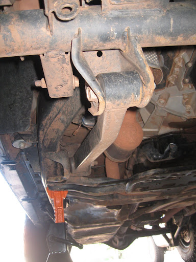

Rancho makes a set. Although I'm not impressed with their customer service (still waiting on a return email from them (months later. Don't believe they'll ever get a big order from me) But for $100 they hold up very well. After my last trip to Moab, I'm wondering if anyone's going to come up with a skid for the upper mount of the lower control arms. Don't know how I banged'em up so.

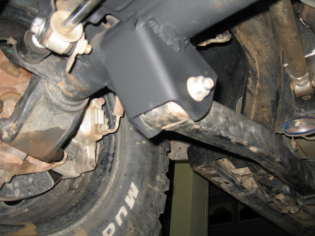

I've been sliding my JK on ORE's front control arm skids since last summer. Very Very happy with them. I prefer items that are weld on, no worries about it coming loose later on. Tested them out the first weekend I had them on this log.

Are you talking front LCA's? If so, I went with Rock Krawler's weld on brackets that incorporate the skid into them.
I smashed one of mine up like this...
Which doesnt suprise me, as flimsy and weak as that bracket is. I bought both the replacement RK brackets for the front, but before I got them welded up, this smashed one broke off of the axle completely. I since ground off the trail repair weld job, and a buddy welded up both brackets for me. MUCH more solid, and I have drug them over many rocks with nothing more than some scratches on them...
