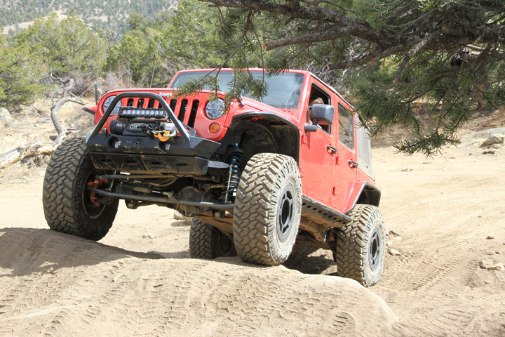

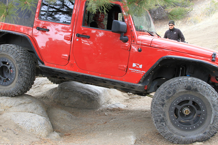

I am running about 3" inches of lift on 37's. Your wheels will need 3.75 inches of backspacing for 37's. Once you get 37's you will want 40's especially if you are following 2 doors on 37's with a JKU.

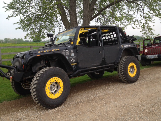

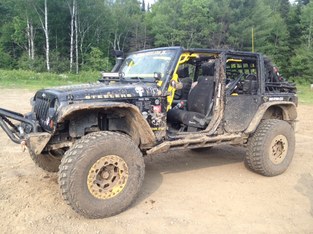

3" TERAFLEX lift with their coils 4 control arms kit also 1" spacers in there.... Bushwhacker flat fenders oh 37" MTR's w Kevlar

ID:	643553   Click image for larger version

Thank you! I have Evo Plush Ride 3" Springs and Rancho 9000 XL Shocks, no spacers.
