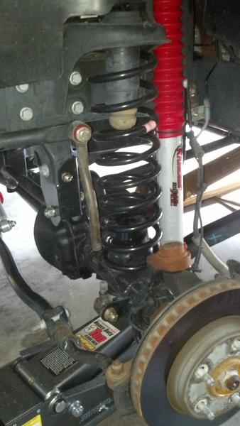

Funny how many times lift installers torque control arms while on the rack. I guess it's easier to access them in the air instead of sliding under after the Jeep is sitting on all 4s.
Attachment 577690
yes...hence, premature failure!

Old Sep 29, 2014 | 10:43 AM
Jeepstin12's Avatar
Posts: 2,482
From: Denver, CO
Don't torque the bolts until the vehicle is weighted in the axles. Very common mistake.
