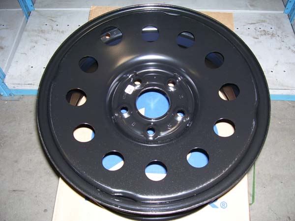

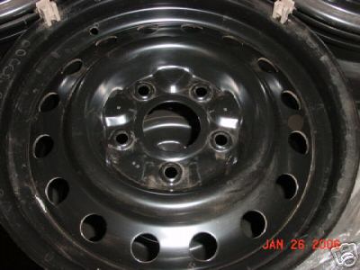

Default Steel JK wheels in the Jeep accessories catalog
Finally found a picture (on ebay) of the Steel Wheels they offer in the JK catalog. Pretty darn ugly. Not at all what I was hoping for.
The 2nd attachment is the stock steel wheel of a grand cherokee with 5x5 bolt pattern. That one is close enough to the Sarge wheels. Too bad it's only 16x7. Really want 8" for 35x12.5

Why not get your set of steels off of a Ram and use spacers for the bolt pattern difference? I beleive the Sarge has Dana 60 in it that uses the same bolt pattern as the Ram. If you want steelies in 17 just use a regular Ram spare and if you want 20 then use the hemi ones.

it looks like a spare tire steel rim, like of the grands, which if I am not mistaking have the same lug pattern as the jk, the only thing i am not sure of is the back spacing
