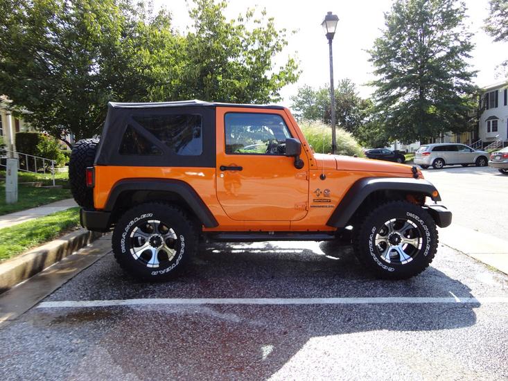

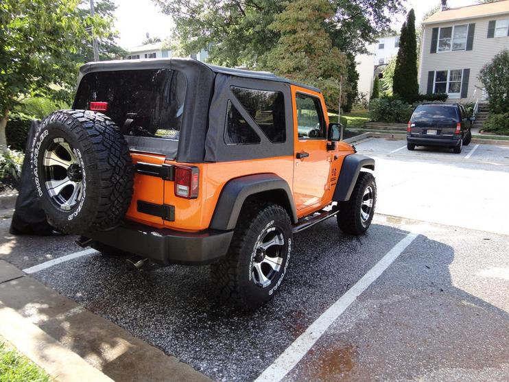

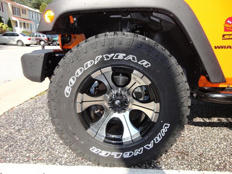

I did the same research about 6 months ago. 285-70-17 is a good size and I have been running mine without any suspension modifications. They are ultimately 33" x 11.3" tires. You will need an aftermarket set of wheels though with 4.5" backspacing or less so that you don't have rubbing issues or just get some wheel spacers to push them out a little if you are using stock wheels and that will keep you from rubbing as well. I got 17x9 Dick Cepek 2 wheels. I don't have any rubbing or anything and it looks really good. Below are some pictures of this set up. The tires are Goodyear Wrangler Duratrac's. Good luck!
ID:	415011Click image for larger version
ID:	415012Click image for larger version
