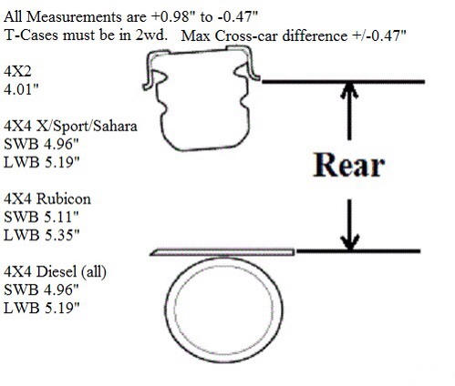

2014 JKUR with MC 2.5 G-C ARB. With the above reference points, I netted exactly 3.69" in the front and 3.69" in the rear with stock bumpers, carrier, etc. Surprised, as I was hoping to eliminate the factory rake. I still have a 1" disparity front to rear.
Finally got around to mounting my Teraflex hinge/carrier and my 35" spare. The disparity has been reduced to 1/2". Stock rubi wheel/tire 73#. Stock hinges 5#. Raceline/KM2 109#. Teraflex carrier 45#. Net gain of 76#. I should have leveled it out with 37's. lol

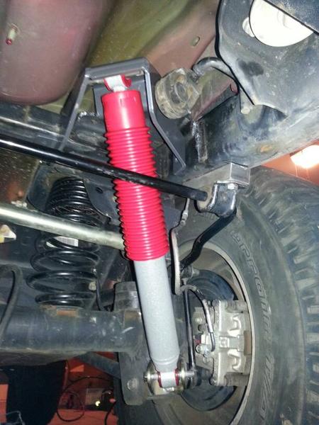

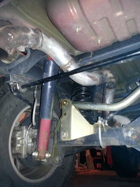

I have the same shocks and 2.5" coils for my 2 door. I'm mounting the rear shocks tomorrow. I've been running the springs for a couple of months already.
I'm using 2.25" rear bumpstops, Metalcloak raised lower shock mounts and Synergy raised upper shock mounts. This combo should work just about perfect for shock length. The 2 minor problems I see: short 2 door driveshaft won't last long with all the extra droop, the current 6" raised Metalcloak trackbar bracket still looks like it will hit rear coil crossmember at full stuff without increasing the bumpstops to 2.75"-3". I may ask Metalcloak about getting the newer shorter bracket.
I haven't decided how to mount the front shocks yet. I don't want to run 3" bumpstops up front. I have Bushwhacker flat flares and small 35" tires. At full stuff I only need 1"bumpstops. I don't want to do 3" bumpstops up front since I only have 2.5" coils. I'm trying to decide if I can fabricate a higher upper shock mount or lower the lower shock mount or a combination of both. I have seen other front shock towers but none of the keep the same stock factory style mount.
This is how I have be running the stock rear shocks for the last couple months.

This is what I'm currently installing to run the longer Rancho shocks.

Nice, I have the rear 32xl shocks and MC lowers (not installed). Def need synergy uppers to not limit up travel to near nothing with TF's rear 2.5 bump stops.
Where's the rear bracket hitting ? Can you alter it and maybe run the lower hole ?

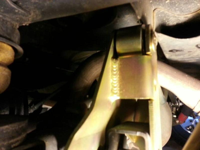

The lower hole is not an option, that was used when manufacturing. The bend that extends to the u-bolt area wouldn't allow the trackbar to fit in the lower location.
The bracket hits on the upper crossmember, near the coil bucket. Metalcloak says it won't hit because the coil will not compress that far, based on my measurements it will be close. I haven't had the chance to fully flex it with the springs installed.

Gotcha,
The new bracket was made for 2 doors @ 2.5 iirc.
I actually sent MC a message. Seeing if I could get ahold of a returned/swapped higher bracket.
Might work for me. I don't want to risk it and buy new.
