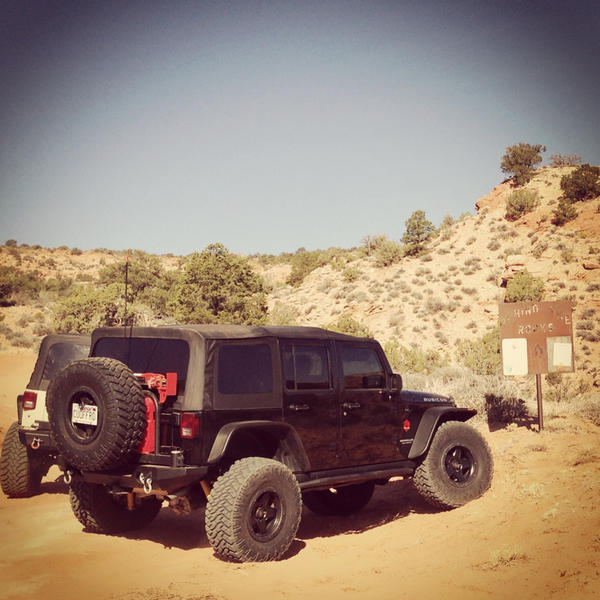

In fact my friend Jeff, tan JKU in the videos, has the 4" Full Traction bolt on long arm set up with EVO coil overs in the front and EVO Lever setup in the rear. I've only moved his around on the trail and not actually ridden in it more than that though. We are both running 37s, him the Toyos and me the Nittos. I'd say overall they're pretty comparable rigs. I generally use him as a guide to see where I can or cannot go. He just ordered Dynatrac 60s front and rear so that will be changing soon.
As far as actual lift with weight, I'd say I still got 3.5 out of mine. I think they calculated heavy bumpers, winch, etc... into them. Below is the only photo I have on my phone right now but it shows mine with full weight, except hard top but with 5 people and tools, and his behind me. They are about the same height.

Ride is great. He has even commented on switching his control arm joints over to the Metal Cloak ones. We're all a little biased with what we've spent our money on but I researched this system, as best as possible, and am happy with my choice even with the OME shocks. At first I thought I'd be disappointed not running the "6-pack" shocks but now I don't see the need for them. That extra $1600 bought my tires (almost).

I don't have this setup "yet" but this is correct as I talked to Matson @ MC and he said if you were to install GC 3.5 on a stock rig (weight wise) it would really lift you about 4-4.5 inches. With the weight of bumpers, armor, etc you actually get the 3.5"
