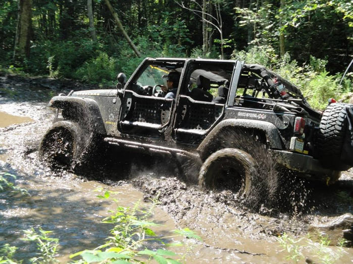

For ppl running the 3.5" duroflex kit, what shocks are you running? Brand and lengths? And why? Also I know it will probably look funny but I'm going to be running the 3.5" with 33's for a year, anyone got pictures of this? I have a 4dr.

Originally Posted by Cobb_Sahara
For ppl running the 3.5" game changer lite, what shocks are you running? Brand and lengths? And why?
Springs are the same on the Dual Rate 3.5 and I was told measurements by MC and purchased Bilsteins on those measurements. River City Offroad also got the right part # when I asked them which size I should go with:
BILF24-186872 Bilstein 5100 - Front Shock (E174-H0) 16.41 Compressed x 27.56 Extended
BILF33-186887 Bilstein 5100 - Rear Shock - (E175-H0)16.96 Compressed x 27.36 Extended
Come on MC, send me my lift!!!!
