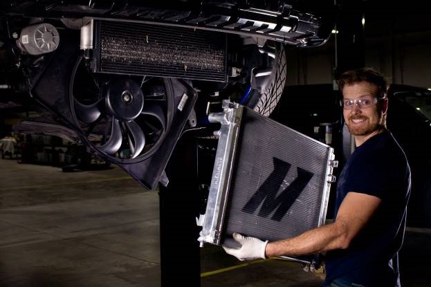

We suspect that the issue may lie within the tolerances of the radiator mounting points or with chassis flex, but we cannot be sure without more feedback from customers. If you filed a warranty claim or had this issue in the past, but were not asked about your vehicle, please PM me and I will gather that information as well.
We’re also looking for somebody in the Wilmington, Delaware area to let us borrow their 2015-2016 JK so that we can get an in-person look. This vehicle would preferably be close to stock to eliminate as many variables as possible. So, if you or anybody you know would like to help us get to the bottom of this issue and wouldn’t mind us borrowing your car for testing, please let me know.

One of my goals in life is to embarrass Jason at least once per post
Jason and our other engineers work tirelessly with our project managers and manufacturing team to make sure that we produce the highest quality products available. If anywhere along the development process we see something that doesn’t meet our strict quality standards, we make sure it’s corrected and test again and again until those standards are met. That process doesn’t end once a product is released either; we’re constantly evolving and improving upon our designs.
