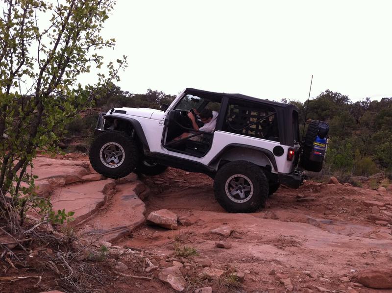

Basic recovery equipment and spare fluids are good to have. Best advice I can give is get a trail book of Moab and research all the trails. Determine what you want to to do and go after it. My recommendation since its your first time do "Top of the World". It's a fairly long trail but as long as its dry a stock rig can make it without any issues. Bring your lunch and enjoy the view from the Top. I attached two pics from last years run.
Man that is a nice picture.
X2. Nice pic. Hope it was used for your Xmas card.

jeepfreakjk's Avatar
Posts: 318
From: Edmonton, AB
I've seen ppl pull right out to the edge but holy I'd be way to nervous to do that lol
Old Jan 10, 2013 | 02:43 PM
ronin2120's Avatar
Vet Army
Posts: 1,046
From: Fort Lewis, WA
My wife was guiding me forward thats as close as I cared to get. I could swear I saw dollar signs in her eyes as she kept egging me on to get a little closer
