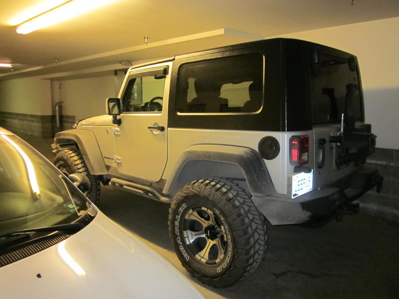

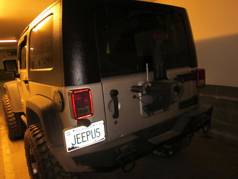

I monstalined the inside and outside of my hard top. Each side took about a day to clean/scuff/tape and apply. If you're doing the tub I would highly suggest spraying. The exterior of my hard top was easy, but the inside was a pain. The roller couldn't do nooks and crannies so I was stuck jabbing at it with a paintbrush for the majority of the time. It's extremely tiresome.
I used tack cloth to pick up the dust my shop vac couldn't. I also used a MEK substitute before and after scuffing.
Either way, you'll want a good respirator. Otherwise you'll get a WICKED headache.
I finished the day before I deployed (surprise notification) so it's been sitting in my garage since May. I can't vouch for fading or wear yet but it looks pretty darn sharp.
